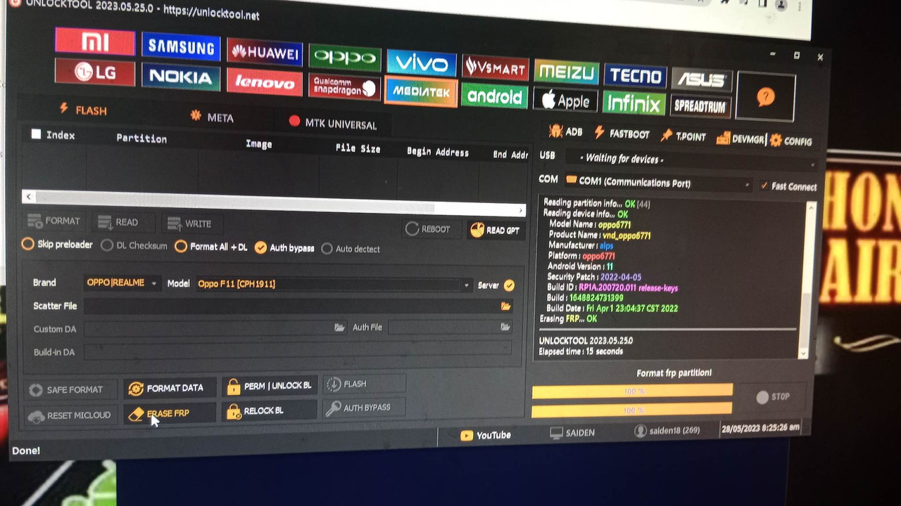

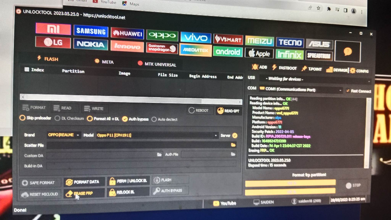

PROCEDURE
OPPO F11 CPH1911
FRP BYPASS AYAW GUMANA SA
*#813# *#812# NEGATIVE SYA
KAYA NAG LOG IN AKO SA
UNLOCK TOOLS
CLICK MO UNG MEDIATIK
CLICK MO UNG FLASH
TAPOS CLICK MO UNG SERVER
CLICK MO UNG BRAND HANAPIN MO
OPPO REALME
THEN CLICK MO UNG MODEL
HANAPIN MO UNG OPPO F11 (CPH1911)
THEN READY MO UNG USB CABLE
HOLD VOLUME UP DOWN
CONECT MO USB CABLE
CLICK MO ERASE FRP
WAITING MO HANGANG MATAPOS
test keyboard keys
spacebar not working windows 7
DONE

wla ba screenxot sir before & after.. tnx..
