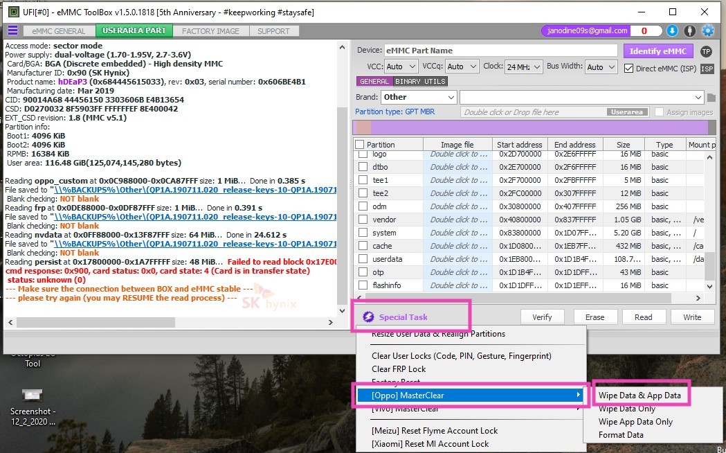

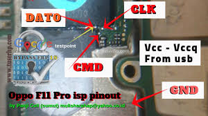

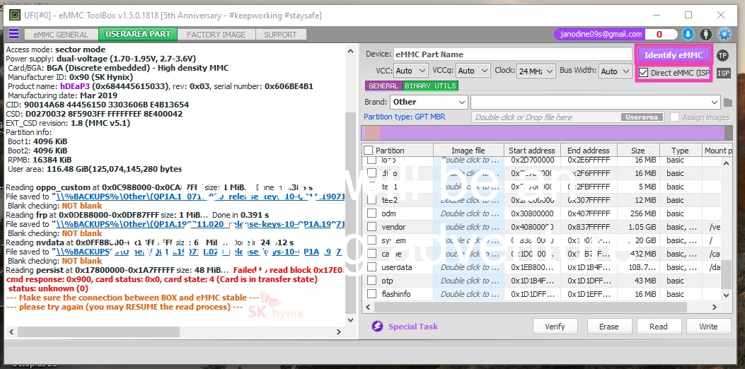

Procedure:
1. BAKLASING ANG UNIT
2. TP
3.DERECT EMMC ISP & IDENTIFY
4.USERERIA PAR1
5. SPECIA TASK

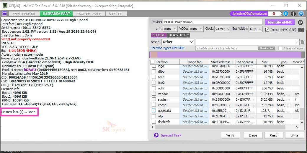

6. OPPO MASTER CLEAR & WIPE DATA & APP DATA
nicole boerner
Alhamdulillah
DONE
