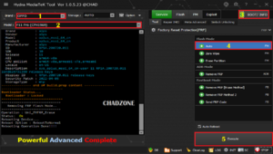

FOR PASSWORD/PATTERN PROBLEM
HARD RESET KO LANG
ENTER RECOVERY (POWER+V.DOWN)
ENGLISH
WIPE DATA
FORMAT DATA
ENTER VERIFICATION CODE:

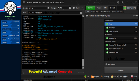

FOR FRP
OPEN HYDRATOOL
BOOT/INFO
INSERT USB CABLE(BOOT KEY V+ , V-)
WAIT TIL DONE
DONE REMOVE USB CABLE
CHOOSE FACTORY RESET PROTECTION(FRP)
AUTO
EXECUTE
DONE!​
