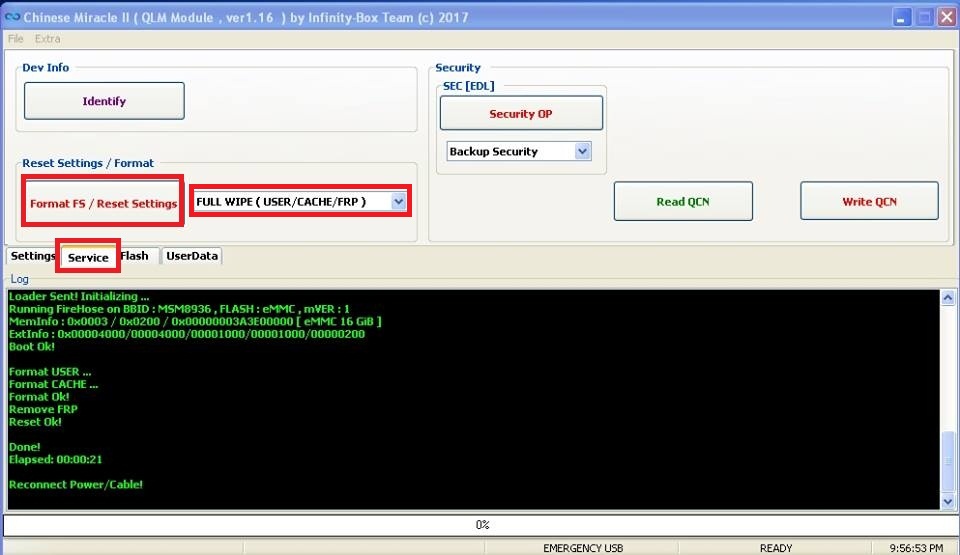

1 power off unit
2 run CM2 QLM Module
3 click Format Fs in service tab
4 hold volume up & down
5 insert usb cable

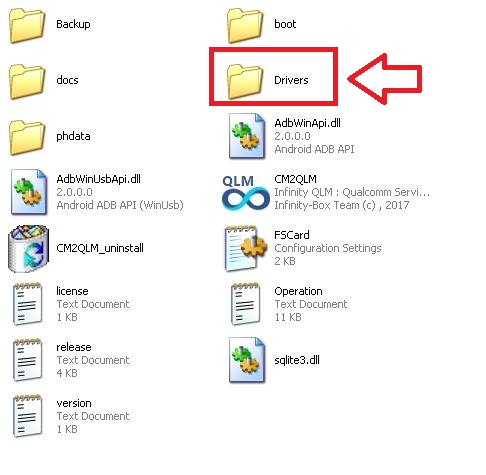

Nga pala dito kunin ang driver sa destination ng cm2 qlm folder

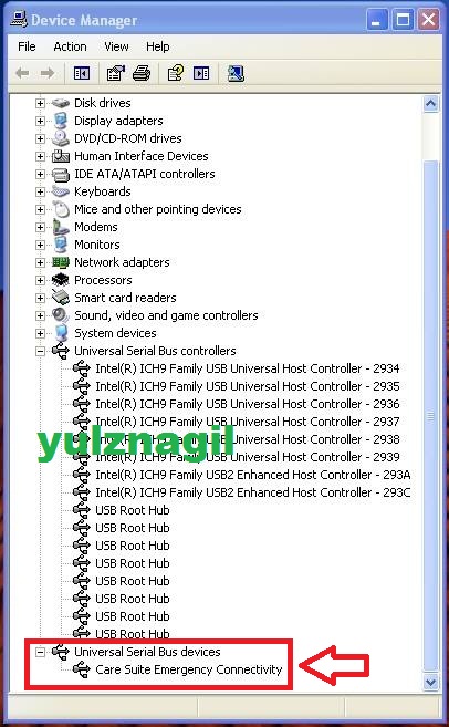

Note: check device manager Dapat ganito ang driver na lalabas
DONE
