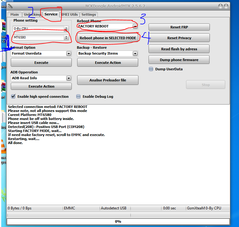

PROCEDURE
turn off phone
open nck crack
sundin nasa pic
hold volume up then salpak usb
wait mag factory reboot
then choose clear emmc
wait until restart

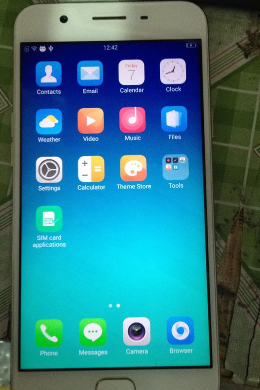

pag meron frp
just do this (nakuha ko lang din dito thanks kay boss julay)
click emergency dial *#812#
bigla nalang sya pupunta sa menu
then ayusin lang po language
finish product
thanks for viewing
salamat sa share boss.,tested kagagawa ko lang ngayon.,keep on sharing boss
