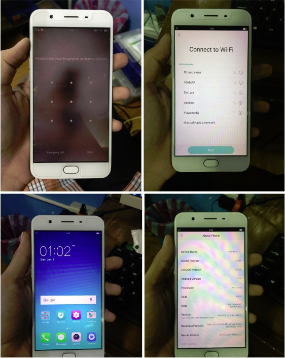

UNIT:
OPPO F1S
ISSUE:
FORGOT PASSWORD/FRP LOCK

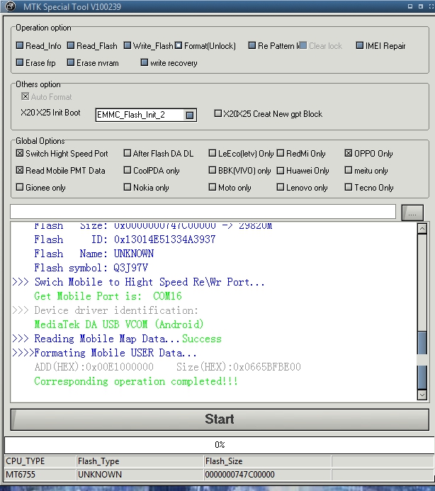

OPEN MRT
CLICK MTK TOOLS
PARA SA PASSWORD
SELECT FOMAT/UNLOCK
SEE PIC
CLICK START
SALPAK UNIT
BOOT KEY (VOLUME DOWN)

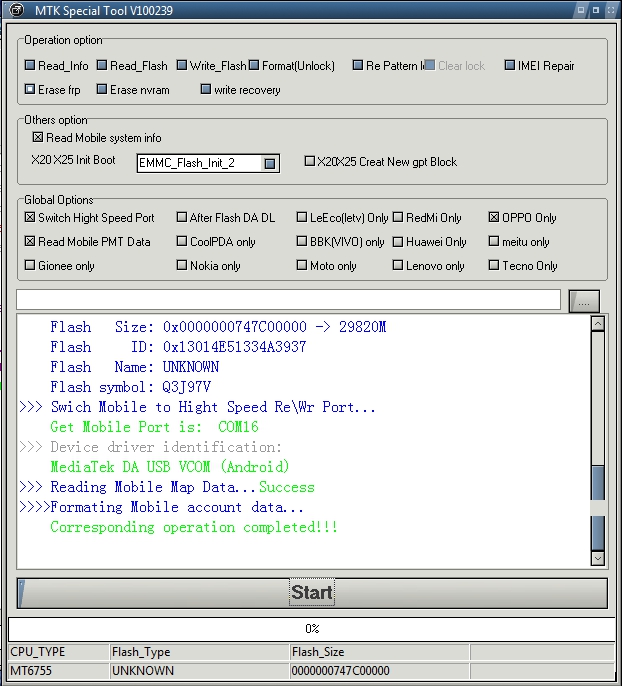

PARA SA FRP
SELECT ERASE FRP
SEE PIC
CLICK START
SALPAK UNIT
SAME BOOTKEY
DONE !!!
