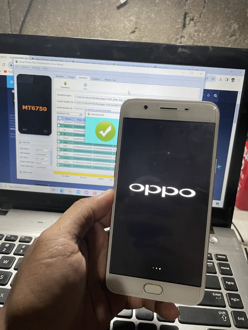

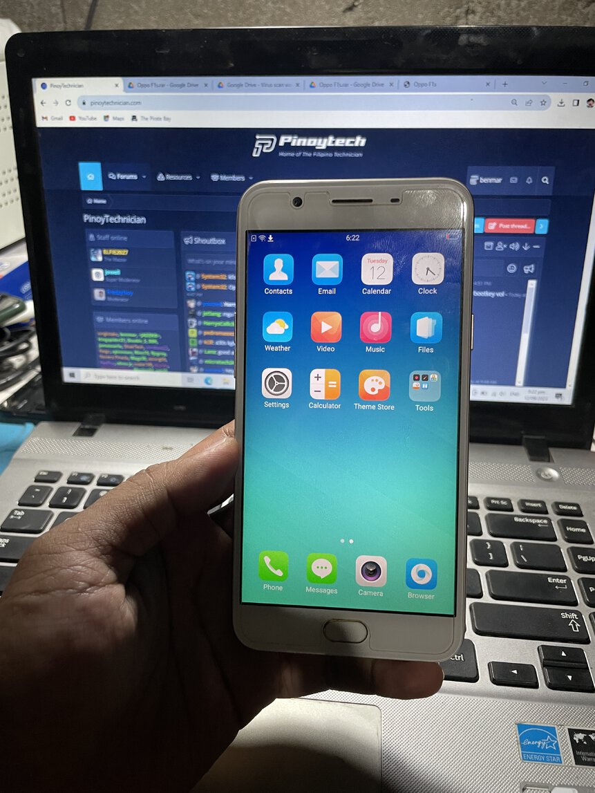

Nag diy dw si tumer may kita sa youtube kaya flash ayun stuck recovery mode ,,,
https://drive.google.com/file/d/1RTkPsp9JdT8DaOCTI9tGhOf7uv-uu7zi/view
Open spfash tool
Scattere load file
Uncheck mo preloader
Click download
Press volume up and down
Open spfash tool
Scattere load file
Click download
