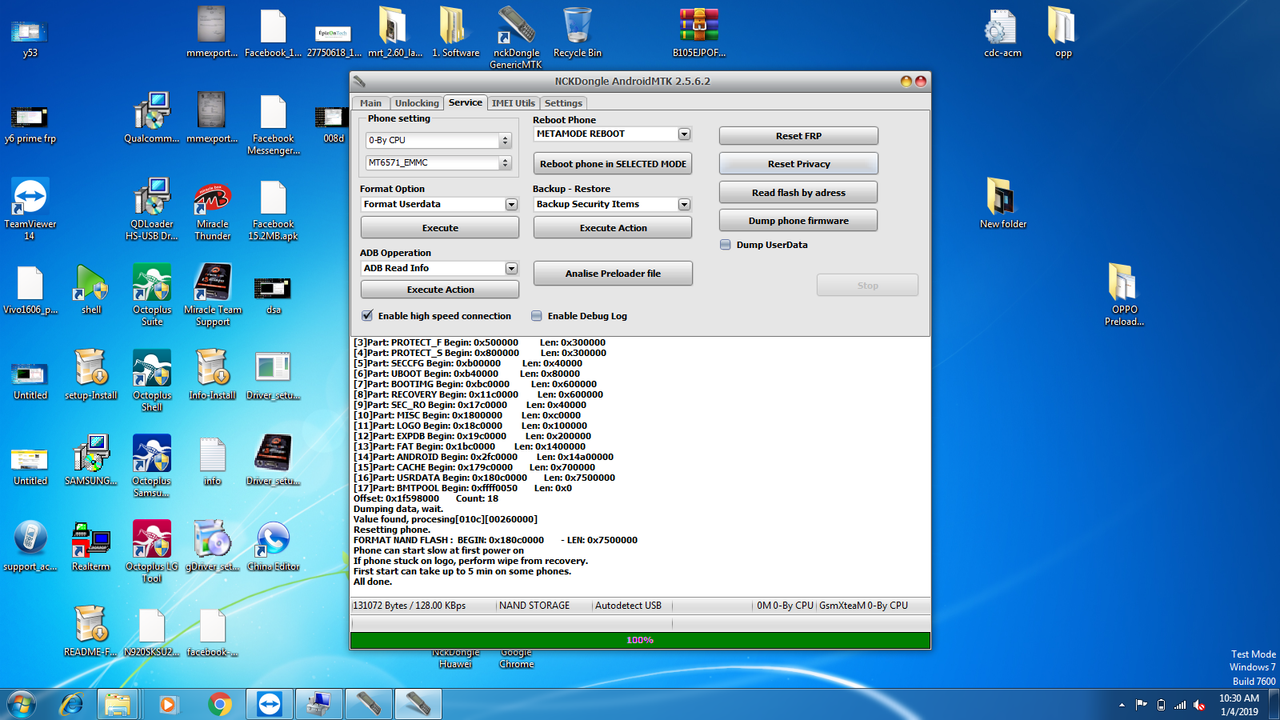

good morning mga ka ants, my share lang po ako oppo f3 clone privacy locked, na try ko kay cm 2 no luck, pero kay nck swak na swak,,,
-Open NCKBox AndroidMTK
-Select MT6571_EMMC in Phone Setting
-Hit Reset Privacy Button
-Connect the phone and wait until done.
https://postimg.cc/XXx3wpC6
click thanks button
click thanks button
