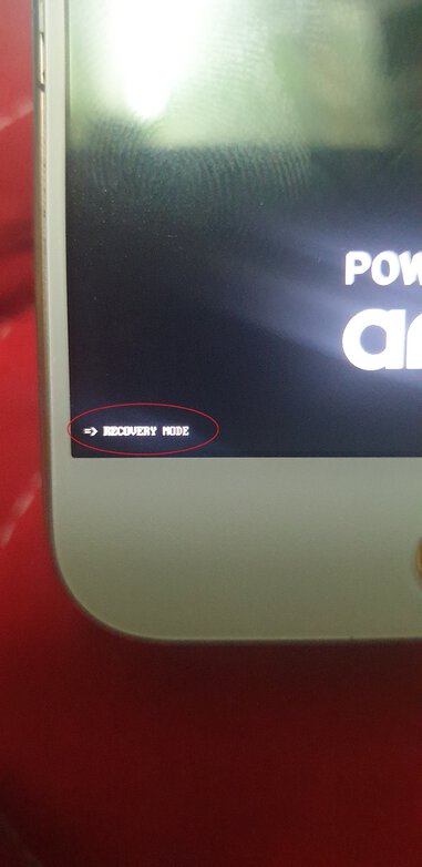

Share ko lang ito mga boss dala ni tumer Oppo f3 Recovery problem
Nareformat lang daw niya, hanggang sa recovery mode nalang lumabas sa screen
At ito po ginawa ko.
DL. Muna itong files
And Extract
Link: https://drive.google.com/u/0/uc?id=1DgpS6l6HBJPO1GCoxrg9OpiLzCt_VZjM&export=download

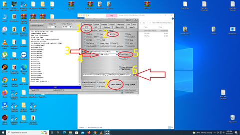

1.Open miracle crack 2.82
2.Select: MTK and Service
3.Click: Write
4.Boot Select : 8th Boot(Mt65xx & Mt65xx/8127)
5.Select. OPPO F3/A77
6. Check: Auto Decry and Only Fireware
7.Check. Skip Preloader
8.Select and Load file firmware
9.Click: Start Button
10. Boot key: press & Hold Volume up and down and Connect Usb cable
Antayin lang matapos

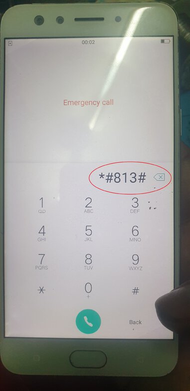

For FRP
Dial lang *#813#
Ito po proof ko

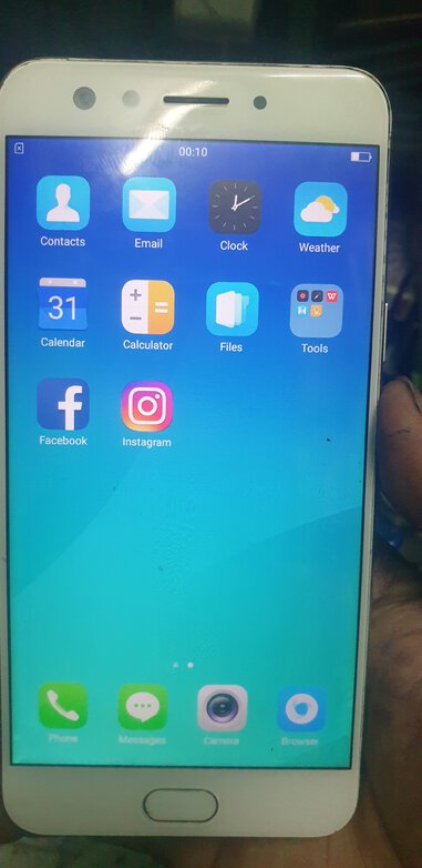

maraming salamat po bossing at sa tahanan na to, you saved my day, muntik na akong maka abono a pattern issue lang kc to tas biglang nag stop sa recovery hahaha buti nalang nakita ko tong post mo boss
tested nga po.
