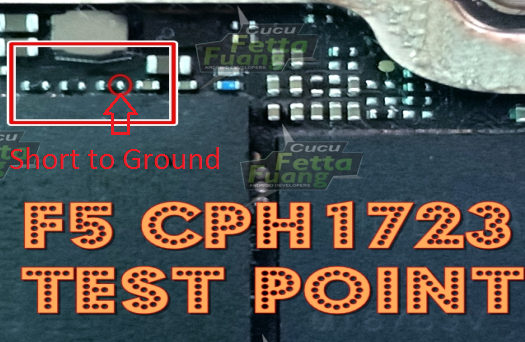

Solder Wire sa Test Point capasitor

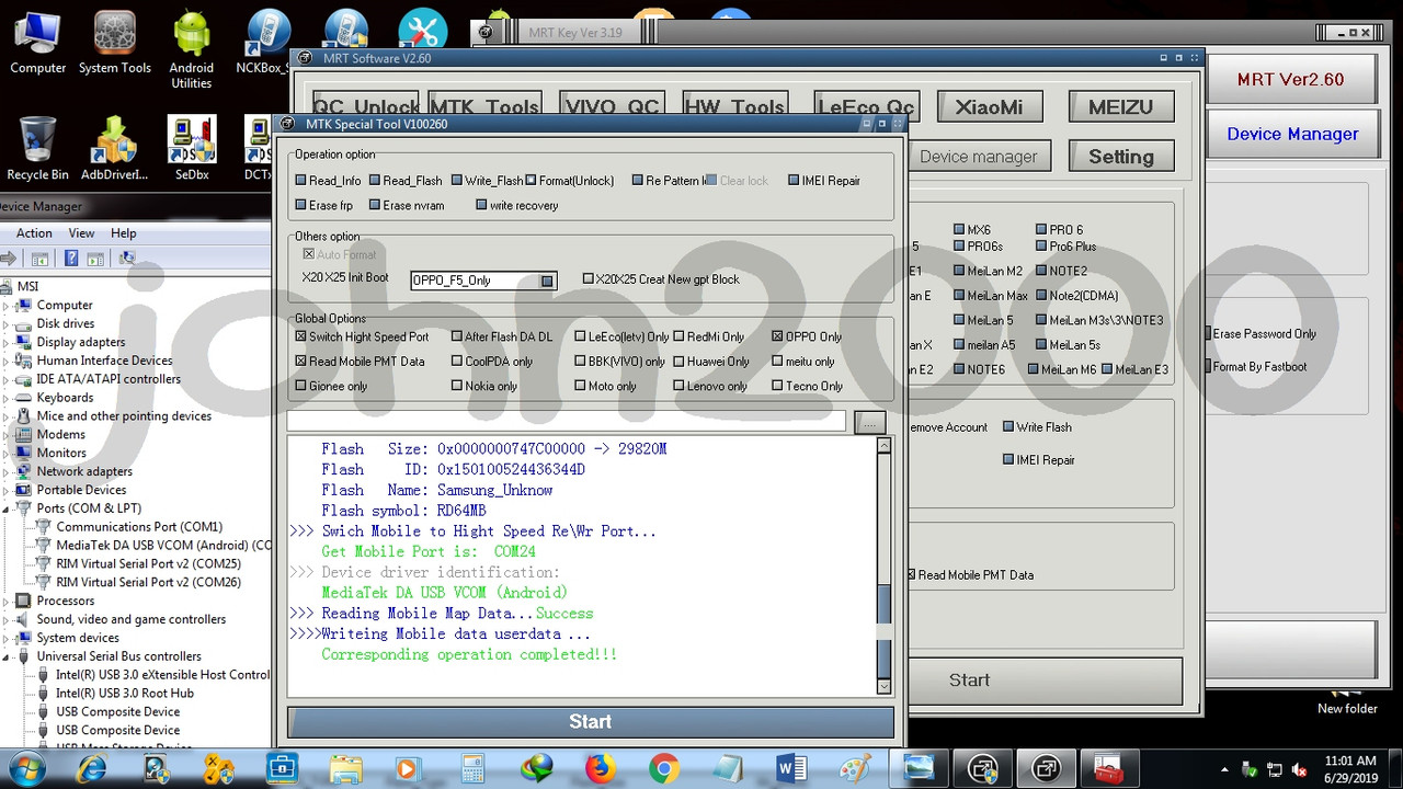

Run MRT_V3.19 GUI
Click MRT Ver2.60 button
New MRT Ver2.60 GUI Popup
Click MTK Tools button
New MTK Special Tool V100260 GUI appear
Click Format (Unlock) box in Operation Option
Click Oppo Only in Global Option
Select OPPO_F5_Only in Dropdown List
Short Test Point to Ground
Click Start Button in MTK Special Tool V100260 software
Insert CA-101 Micro USB Cable no need press boot key
Disconnect Test Point once device is detected in Device Manager
Wait till Operation Completed

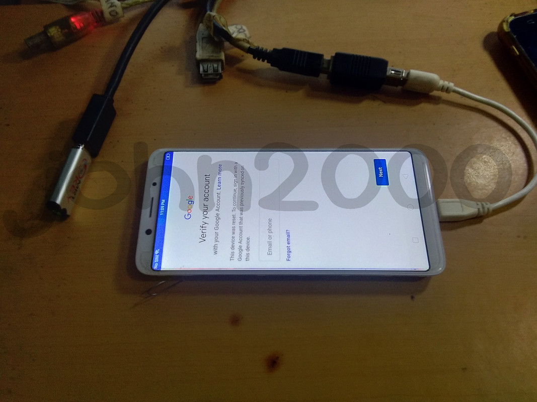

Result :
BOOM!!!! nag power na...
May FRP pa
Tap Emergecy call
Dial *#812#
Done..
