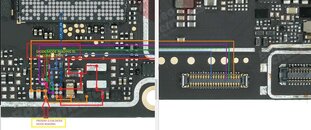

OPPO F5 LOW BRIGHTNESS
NAKA ILANG TRY NA PALIT LCD COTECH SAME ISSUE LOW BRIGHTNESS KAHIT ITODO SA SETTING
1ST TROUBLESHOOT NA GINAWA NILA CHANGE COIL NO LUCK
ITO NAMAN ANG AKING GINAWA
DISASSEMBLY UNIT PARA MA TROUBLESHOOT NATEN MAAYOS
OPEN BORNEO PARA MAY GUIDE TAYO
KUHA TESTER SET DIODE MODE
MAHINA ANG ILAW NG UNIT SO SA LIGHT SECTION TAYO MAG FUCOS
REKTA AGAD AKO KAY LED A AT NAKITA KO AGAD ANG SALARIN
BASE KAY BORNEO DAPAT MAY 0.407 SA LCD FPC PIN NUMBER 23
PERO ANG NASUKAT NG AKING TESTER AY OL MEANS NO CONNECTION
KAYA GINAWA KO SINUNDAN KO ANG LINYA NYA PARA DON MAG SUKAT
UPON CHECKING PRESENT ANG 0.538 RESISTANT VALUE NYA USING DIODE MODE LED A SA INPUT NI RESISTOR
PERO PAG DATING SA KABILANG SIDE NI RESISTOR AY 0L ANG AKING NASUKAT.
KAYA PALA NO CONNECTION SA LCD FPC NUMBER 23 AY NAG CUT NA PALA DITO KAY RESISTOR
KAYA GINAWA KO INALIS KO ANG RESISTOR AT NAG JUMPER
JUMPER LANG ANG AKING GINAWA SEE PHOTOS
TAPOS CHECK RESISTANT VALUE KUNG PRESENT NABA SA FPC PIN NUMBER 23
AT AYAN PRESENT NA SIYA .
TRY KO NAMAN ASSEMBLE UNIT PARA MA CHECK KUNG MAAYOS NA ANG KANYANG BRIGHTNESS
AT BOOM MAY LIWANAG NA ANG BUHAY HEHE
YAN LANG PO SALAMAT .
