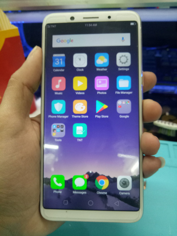

1:[url=https://postimg.cc/ygHKdgd3]

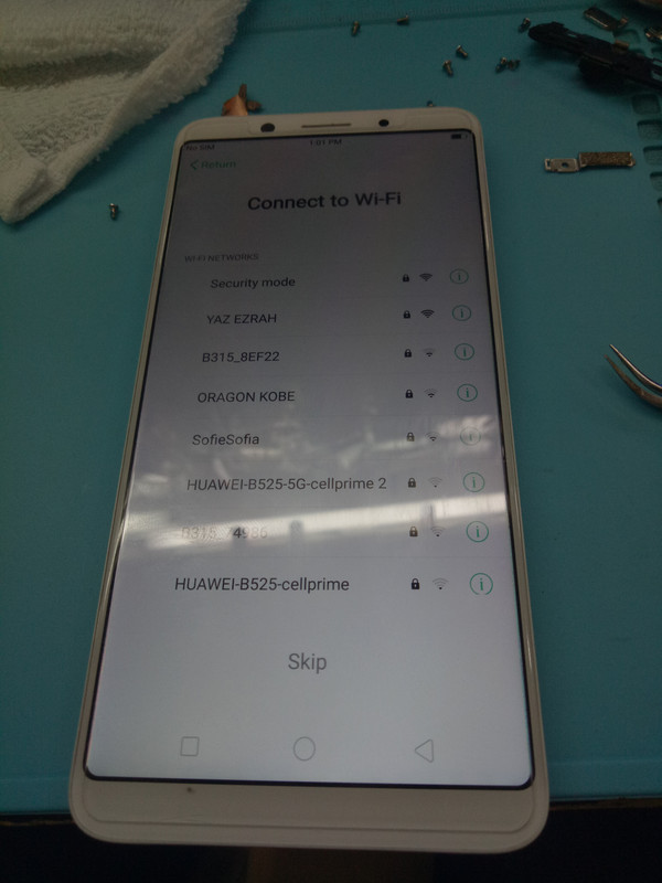

[/URL]2:[url=https://postimg.cc/qttVQct3]

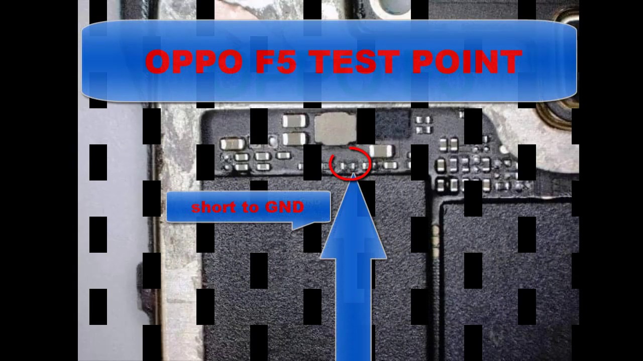

[/URL]pag nag connect tanggal agad test point para hindi mag error katulad ng nasa pic
[url=https://postimg.cc/Wqmcc98D]
[/URL]3:[url=https://postimages.org/]

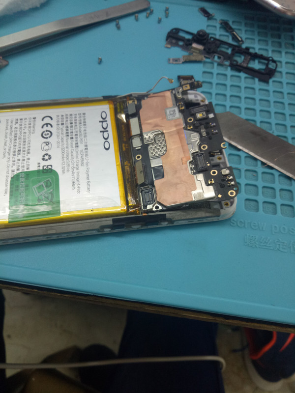

[/URL]4:[url=https://postimg.cc/xqmmhWrs]

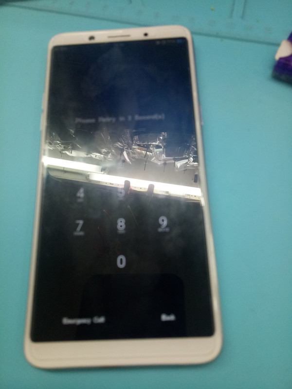

[/URL]din frp punta lang sa emergency dial *#812# call din wait lang hanggang matapus
5:[url=https://postimg.cc/RJG42Sv6]
navigate to the closest gas station[/URL]done sana maka tulong
