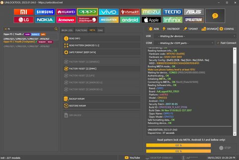

muziquerou Expired Account Joined Nov 8, 2020 Messages 84 Reaction score 145 Points 201 Location Pangasinan Jan 19, 2023 #1 1. click oppo tab 2. search f5 l youth 3. meta tab 4. click safe format 5. volume up + down 6. insert usb 7. wait until matapos (hindi siya mag safe format pero atleast hindi na mag TP ) pag hindi maalis ang frp *#813# lang.

markjohn73 Premium Account Joined Apr 14, 2016 Messages 54 Reaction score 19 Points 1 Location BACOLOD CITY, NEGROS OCCIDENTAL, 6100 Feb 20, 2023 #2 muziquerou said: 1. click oppo tab 2. search f5 l youth 3. meta tab 4. click safe format 5. volume up + down 6. insert usb 7. wait until matapos (hindi siya mag safe format pero atleast hindi na mag TP ) pag hindi maalis ang frp *#813# lang. View attachment 17531 Click to expand... tested po salamat sa pag share po...
