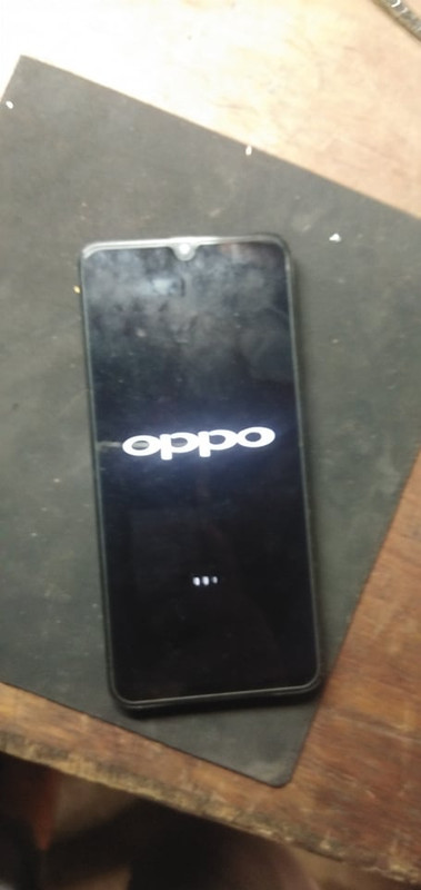

Oppo F9 CPH1823 Hang up
action taken

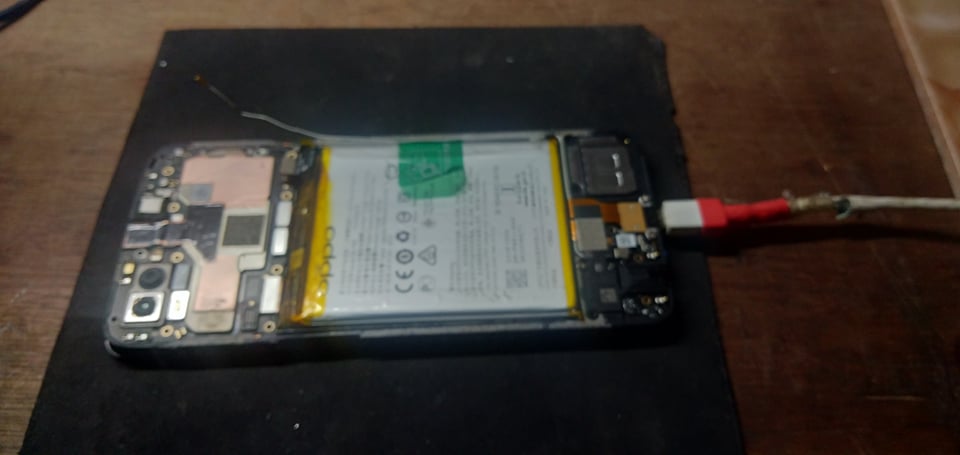

try formar via mrt done.. but same status
try formet via hyrda done..but same status parin
SOLOTION
fullflash the unit via mrt dongle...

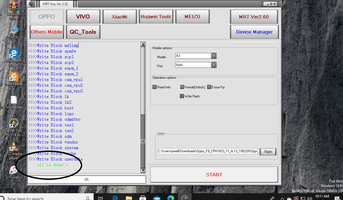

>>>>Write Block userdata
all is done!!!

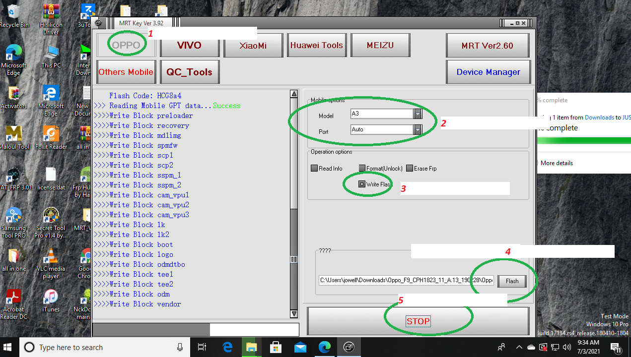

Run mrt v3.92
Oppo
Select model *A3
select write flash
load firmware
download here... Oppo F9 Cph1823..
Click start
testpoint then isert usb cable

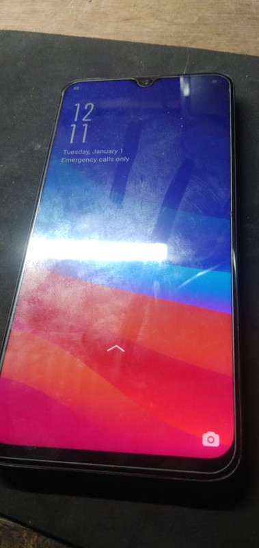

Hintayin ang all is done
Dan...dalandan
