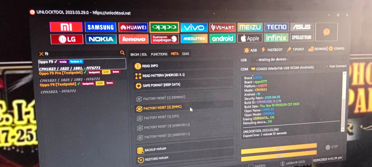

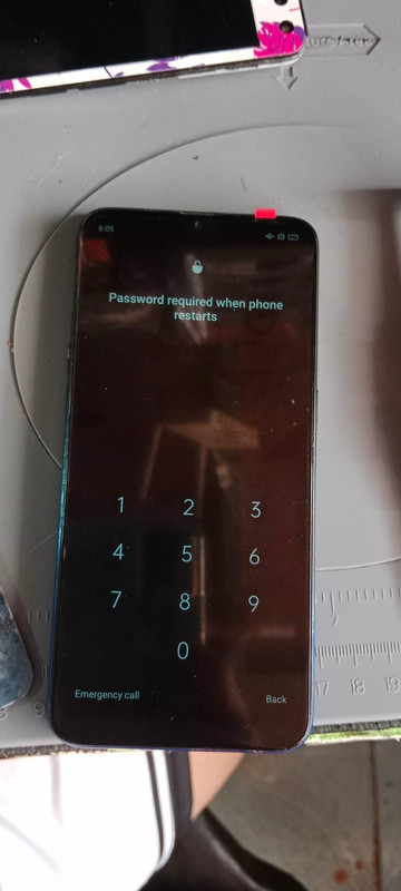

PROCEDURE
OPPO F9 PASSWARD
NO NEED TP
OPIN UNLOCK TOOLS

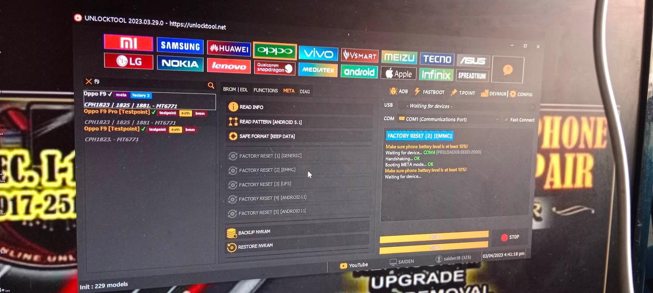

SELECT OPPO TAB
SEARCH OPPO F9 META FACTORY
OFF PHONE
READY MO USB MO
HOLD VPLUME UP IN DOWN
CONECT USB CABLE MO

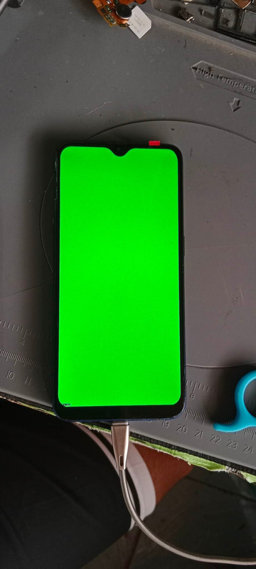

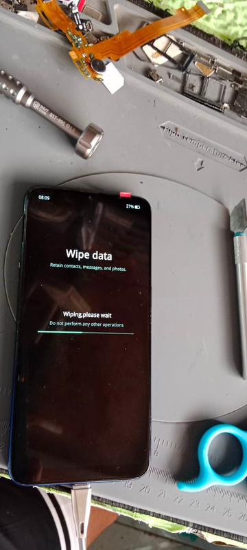

CLICK MO FACTORY RESET 2 EMMC
WAITING MO HANGNG MATAPOS

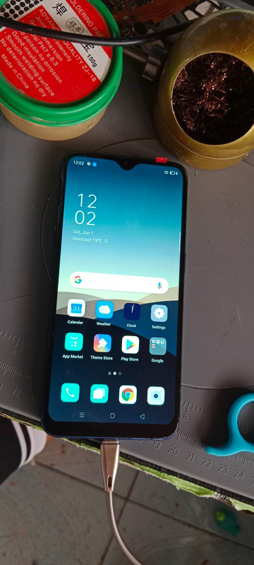

THEN GMAIL ACOUNT
DIAL MULNG *#813#
MATIC NA YAN
cyborg wallpaper
DONE FINISH BASIC LANG
