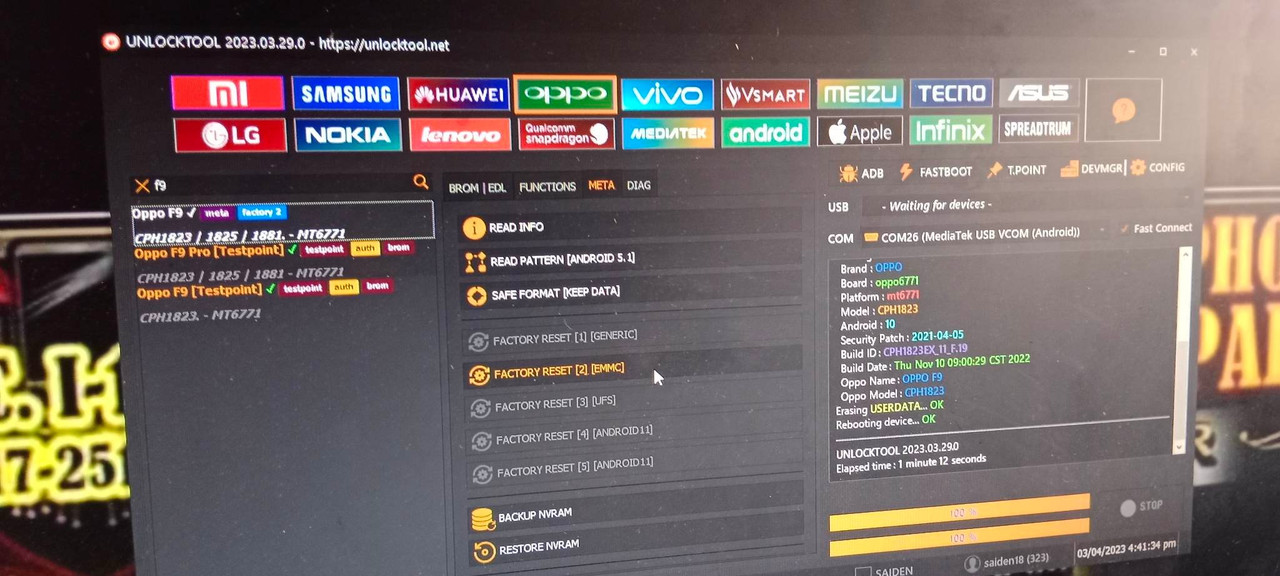

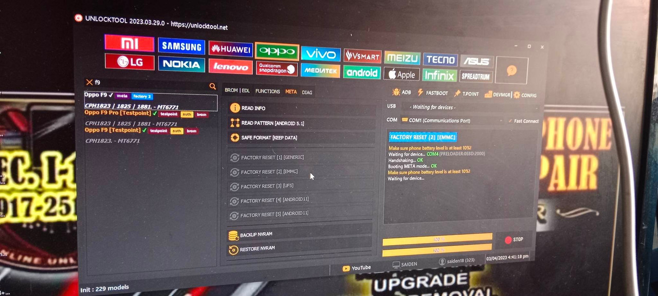

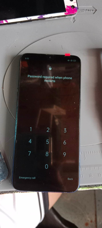

PROCEDURE
OPPO F9 1823
PASSWARD PROBLIM
OPIN UNLOCK TOOLS
CLICK MO OPPO TAB
SEARCH MO OPPO F9 1823
OFF PHONE

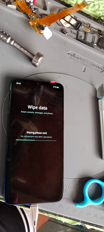

CLICK MO FACTORY RESET 2 EMMC
HOLD VOLUME UP DOWN
CONECT MO USB CABLE

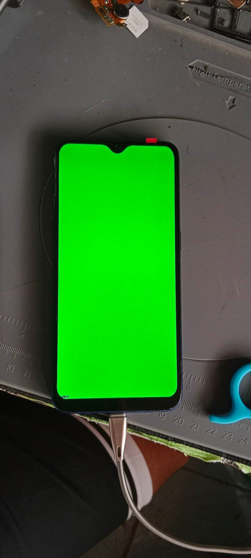

WAITING MO

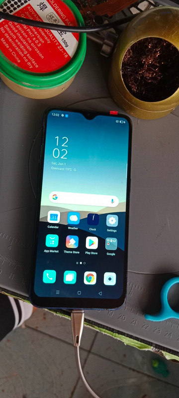

DONE FINISH
