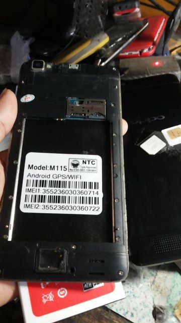

Unit:
Oppo M115(clone)
Problem:
Hang on OPPO logo

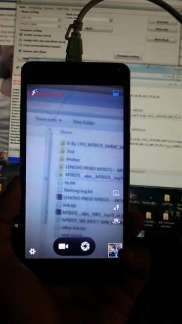

Action taken:
>open NCK_MTK_ANDROID software
>Load Scatter(LENOVO P038D MT6572---MOXXX)
>Firmware Setting ( Check "ANDROID" only)
>Click Write Flash
>DONE.

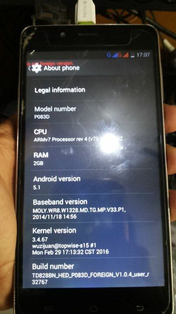

May nakalagay nga lang sa sa upper left side na "is not foreign version'. Pero pwede na rin ok naman
wifi, cam, signal..
>Click Write Flash
