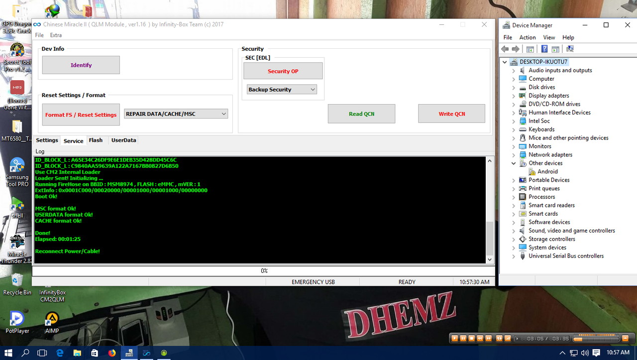

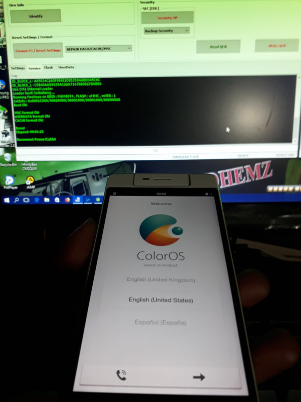

Unit : oppo n3 n5206
Problem : hung Logo
action: update via SD CARD but fielled
ito firmware : oppo n3 download me
kaya try kuna lang sa CM2 QLM
service/
Piliin ang REPAIR DATA/CACHE/MSC
format fs/reset settings
click it wait until done.
Ayun sapul ng okey ang unit kaya share kuna rin tricks natu..hehe..
