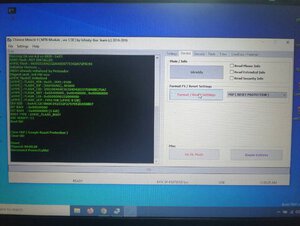

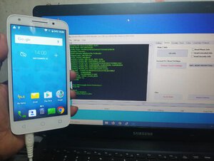

optus x spirit frp remove.
open cm2mtk
select
sp:auto [2601] [6571..6595] [6732..6797] [81|83|87xx|nand|emmc
click (service)
slect (frp reset protection)
click (format reset settings)
power off unit
then hold vol down and connect usb cable
done.
