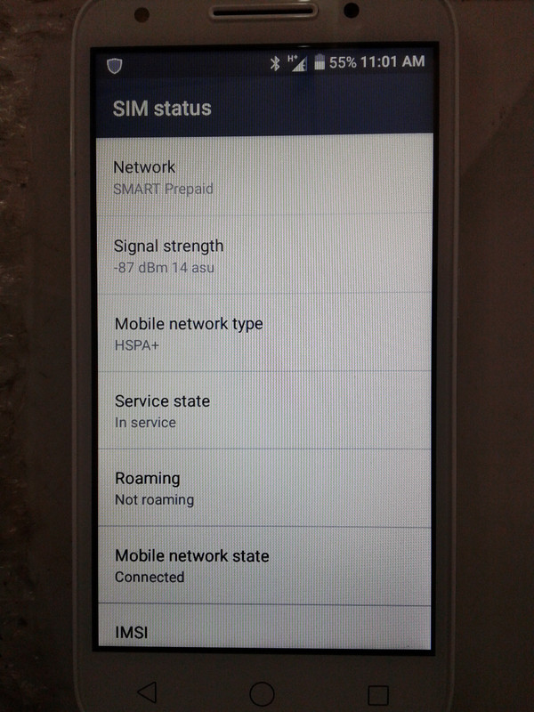

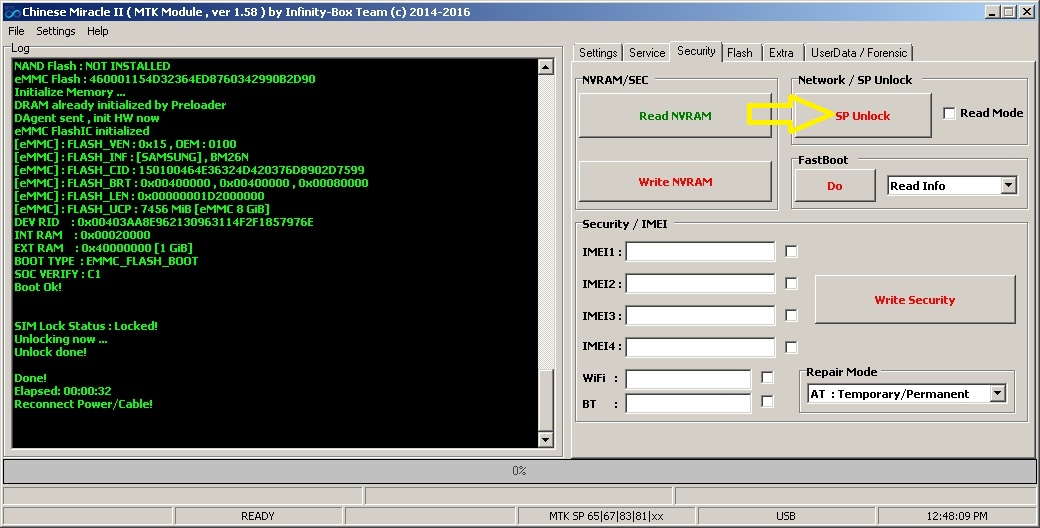

andreivi Expired Account Joined Jul 30, 2014 Messages 1,986 Reaction score 271 Points 381 Location Sison, Pangasinan/ Rosario, La Union Mar 2, 2019 #1 share lang po mga boss for reference Optus X Spirit Unlock done sa CM2 -open nyo po yung CM2MTK -Punta sa security tab -click sa SP Unlock -isalpak sa usb yung unit na nakaoff -antayin matapos
