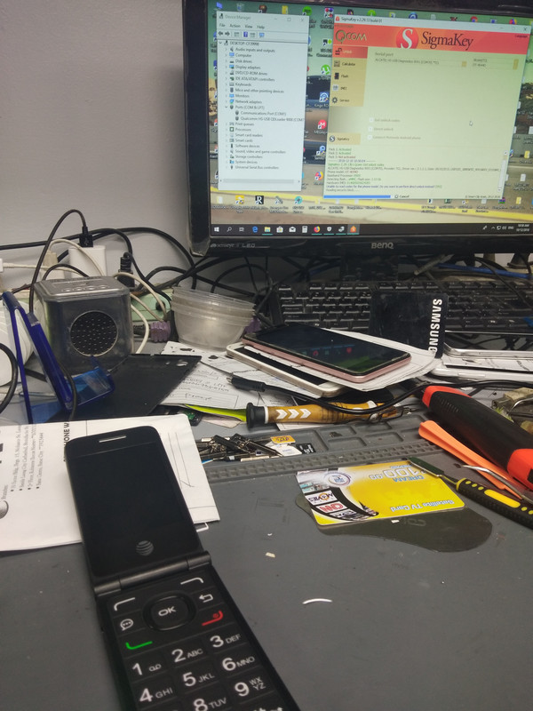

unit alcatel OT-4044O
problem unlock
connect unit sa pc ng naka on...
open sigma
go to qualcom tab
select model
install lang ang importanteng driver...
off unit habang naka saksak
at select diagnostic tab...hit direct unlock...

while unlocking
finish product
logs
SigmaKey v.2.29.13 build 01
3848xxxxxx Sigma dongle 2.29, Initializing...OK
Pack 1: Activated
Pack 2: Activated
Pack 3: Not activated
--------- 2018-12-10 10:50:04 ---------
SigmaKey 2.29.13b1 Qcom: Get unlock codes
ALCATEL HS-USB Diagnostics 9091 (COM70), Provider: TCL, Driver ver.: 2.1.2.1, Date: 08/10/2015, USB\VID_1BBB&PID_9091&REV_0310&MI_00
Phone model: OT-4044O
Baseband Processor: 8909
Detecting flash...eMMC, Flash size: 3.53 Gb
Hardware IMEI: 014685005624285
Unable to read codes for this phone model. Do you want to perform direct unlock instead? [YES]
Reading security block...XWB9UA30BR00
Security area saved to "C:\Users\hf-iontech\Documents\SigmaKey\security backup\0384881860\014685005624285_8909_eMMC_XWB9UA30BR00.skb"
Removing firmware protection....OK
Unlocking phone....Done
