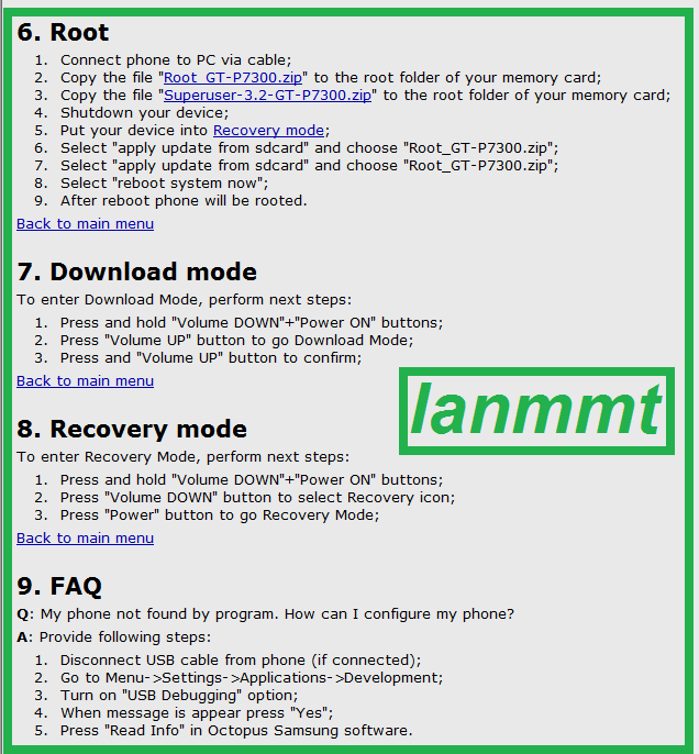

Procedure : 1
1. Root first (download mona ng root file) makikita rin sa manual, Click lang direct link yung ROOT file
2. How to ROOT (makikita rin sa manual paano) sundan nalang po yung guide
Procedure :2
To connect GT-P7300B phone you have to perform the following steps:
1. Disconnect USB cable from phone.
2. Go to Menu->Settings->Applications->Development.
3. Turn on "USB Debugging" option.
4. When the message appears press "Yes".
5. Connect USB cable to the phone.
6. Press "Read Info" in Octopus Samsung software.
Tick UNLOCK
Unlock Done
