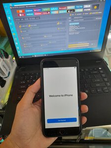

Okay na boss, Sa windows10 ako nag open ng UT.

niligay mo na din sana boss kung pano mo ginawa step by steph para madali masundan ng iba..salamat

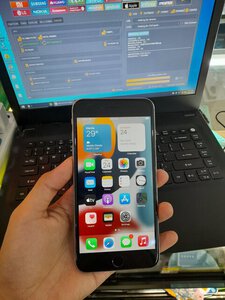

supported boss, okay na rin sa win7 ko pambypass

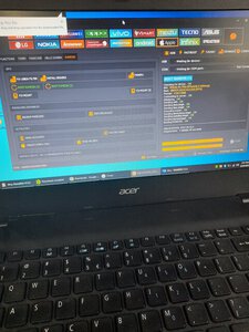

boss ano ginamit mong cable harmony ba ganto po reading nag fafail po kusa nabubuhay cp
BOOT RAMDISK Checking for device... OK
Info : iPhone 6s Plus [iPhone8,2-n66ap]
Boot : [IBOOT-2234.0.0.3.3] [DFU]
Pwnder : GASTER
Initializing... OK
Sending ibss.img4... OK
Sending ibec.img4... OK
Executing loader... FAIL
Device is not in RECOVERY!
Tips : If device keeps booting up while sending ibss or ibec
Press and Hold VOLUME DOWN + POWER while sending ibss and ibec
After done sending ibss and ibec you can release those buttons.
