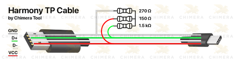

Exynos27 Registered Joined Jul 22, 2022 Messages 67 Reaction score 24 Points 201 Location Mariveles Bataan Philippines Feb 28, 2024 #1 pahelp mga boss pano gumawa ng pang harmony tp cable at anong tamang value ng resistor ang kailangan?

Zainal H.daud Registered Joined Oct 28, 2021 Messages 158 Reaction score 56 Points 51 Location TAYUG PANGASINAN Feb 29, 2024 #3 ganyan gawin mo gamit yung 10k ohms resistor Attachments a.jpg 69 KB · Views: 57
Exynos27 Registered Joined Jul 22, 2022 Messages 67 Reaction score 24 Points 201 Location Mariveles Bataan Philippines Feb 29, 2024 #4 Zainal H.daud said: ganyan gawin mo gamit yung 10k ohms resistor Click to expand... Boss yung 3 resistor ok din ba

bagik Registered Joined Jun 12, 2014 Messages 489 Reaction score 423 Points 71 Location Bignay Valenzuela City Mar 1, 2024 #5 Exynos27 said: Boss yung 3 resistor ok din ba Click to expand... How To Make Own Harmoney TP Cable | Huawei COM1 | Latest Security
