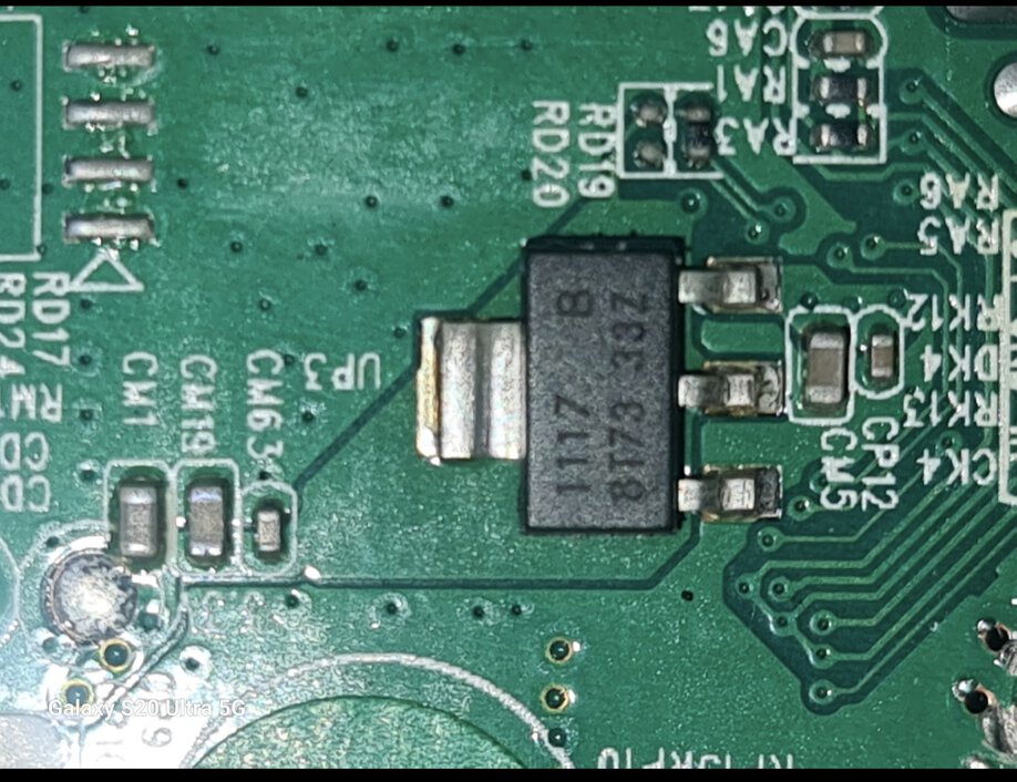

Model:226V3LSB25/71
Issue:No standby power and auto on/off blinking light.Voltage dropout no stable GH12E/ AP2114 3.3v Regulator
Replace with 117 3.3 Voltage Regulator Done!
Power standby and normal again.
Data Sheet Link:http://www.datasheetdir.com/GH12E+LDO-Regulators
1A LOW NOISE CMOS LDO REGULATOR
The AP2114 is CMOS process low dropout linear Regulator the Regulator delivers a guaranteed 1A (min.) continuous load current The AP2114 features low power consumption. The AP2114 is available in 1.2V, 1.8V and 3.3V Regulator output, and available in excellent output accuracy 1.5%, it is also available in an excellent load regulation and line regulation performance. The AP2114 is available in standard packages of SOT-223, TO-252-2(1), TO-252-2(3) and TO-263-3. By BCD Semiconductor Manufacturing Limited
Nag automatic off sya ng kusa tapos mag on ulit.kaya ang ginawa ko check ko lang yung 1.8 at 3.3 smd voltage regulator
Nung nag voltage testing ako via ground to Vout side drop ang voltage sa ng 3.3 smd regulator hindi sya normal at random ang kayang volt taas baba lang.hindi sya naka fixed sa 3.3v kaya yun ang nireplace ko..pinalitan ko ng
17-33 voltage regulator galing ibang unit na monitor....after ko makabit yun gumana na at nag standby na ang power.pwede rin ams1117 guys basta fixed sa 3.3 volt.
