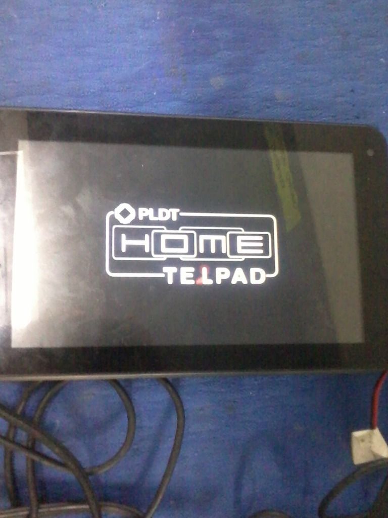

Share ko lng mga master PLDT TELPAD AURA hang on LOGO - DONE
Model : PLDT TELPAD AURA TM7
Board id : Aura TM7_03
Action taken :
1. hanap ako dito wala ako makita
2. tanong ky pareng google wala parin / wala makitang FW
3. naicip ko Rockchip to kaya hanap ako Wiper buti may nkita :D
Sundan nyu lng to : http://www.androidsoldier.com/2013/12/rockchip-cpu-solution-pattern.html
Wiper : http://www.4shared.com/get/RoDnBhg5/RockChip_Android_Tool.html
Driver : http://www.4shared.com/get/RoDnBhg5/RockChip_Android_Tool.html
2016.41.40_zpsnhhsmaaa.jpg[/IMG][/URL]
NOTE : F may error after nyu click ang RUN - select SWITCH sa rockchiptools tas install driver tas run ulet din ur DONE . :D
Salamat po sa pagtanaw :)
