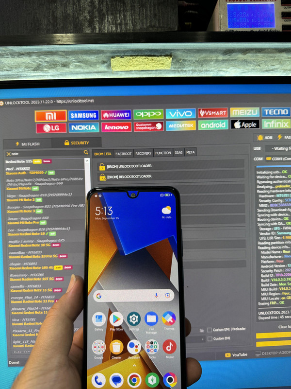

history: nilagyan ng sdcard nagrestart tas lumalabas na dm-verify system corrupted then auto restart
PROCEDURE:
@ open unlocktool
@ select mi tab then select redmi note 11s
@ click unlockbootloader after unlockbootloader
@ select mediatek tab universal mtk
@ click PATCH DM-VERIFY after done
@ papasok sa recovery then wipedata
@ wait and setup unit then smile☺️☺️
