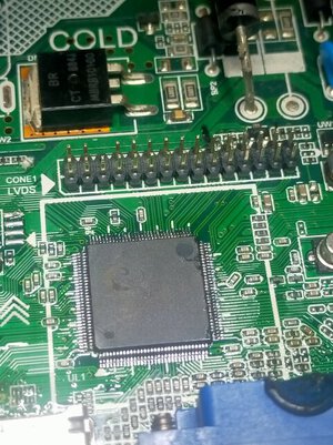

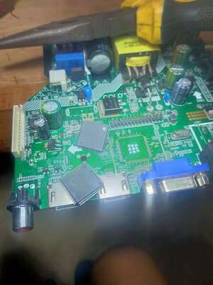

Prestiz 32fd2200 Standby only
Action taken: naka unplug Ang unit testing components via diode mode sa tester no shorted then plug in Ang unit voltage check 12v ok,5v ok, 3.3v ok, 1.8v ok
pero dapat Ang 1.8v hindi present pag naka standby mode
Visual check at kumapa sa CPU at yun high temp Ang CPU kahit naka standby
Kaya nag initiate Ako mag transplant CPU at nag ok na.
P.S. di ko lang na pa kita working na tv nakalimutan picturan
