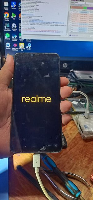

CLICK FACTORY IMAGE AT IPASOK NA NATIN YONG DOWNLOAD NATIN FIRMWARE LONG PRESS YONG RAWPROGRAM XML NA EXTRACT NA SA UFI
LAGAY MO SA RAWPROGRAM XML TAPOS PATCH O XML..
THEN HIT FLASH ANTAYIN LANG MATAPOS WAG ALUGIN USB PARA HINDI MASAYANG PAG AANTAY MO MGA 1 HOUR ANG FLASHING

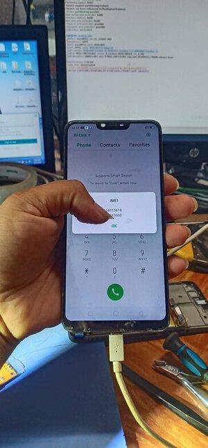

TAKE NOTE HINDI NA AKO NAG ERASE NG EMMC KADALASAN MANG YARI KUNG ERASE EMMC MAWAWALA IMEI DIRECT FULL FLASH NALANG PARA SAFETY
AT PAGKATAPOS FLASHING HINDI KUNA BINALIK USER AREA AT USERPART NA BINA BACKUP KO KASI HINDI AKO NAG ERASE NG EMMC
PARA LANG YAN SA NAG ERASE NG EMMC PARA MABALIK ANG USER BOOT AT IMEI

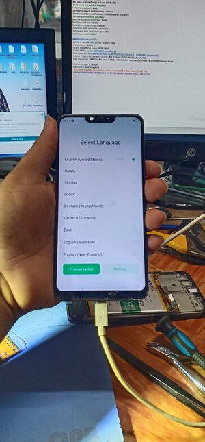

TAPOS MAG FLASH AND YOUR DONE... WITH IMEI
