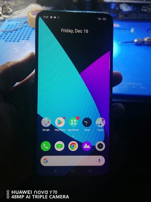

-First ask si tumer ano History nang Cp niya bat nag ka ganyan
-Hindi naman raw nahulog bat nag hang pag lagyan nang sim slot o sim

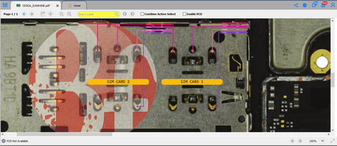

-Visual check ako baka shorted kaya nag ka ganyan pero no short na kahit konti sa Tester
-Then Diode Mode gamit Digital Multitester sa simslot all good ang reading walang gounded/faulty
-Kaya try ku muna flash gamit realme auth flash pero same issue parin hang on logo

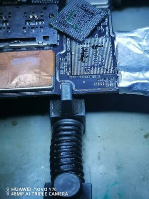

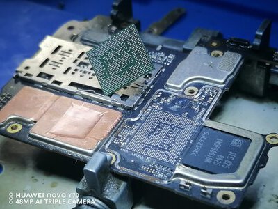

-Next Proceed nako sa Reball Cpu lang
Tools na kaylangan
-QUICK 2008, Reballing Paste Mechanic 183c then Cpu stencil at 2uul sexy blade
-Remove Cpu(Heat) 390 (Air) 60

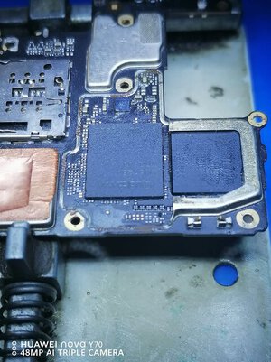

-Back Cpu (Heat) 380/ (Air) 40
