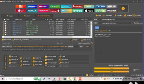

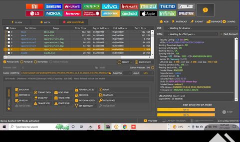

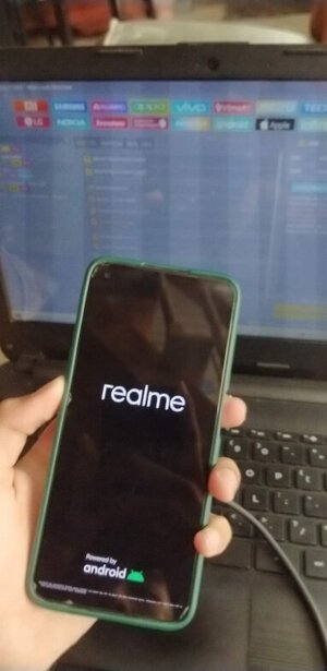

REALME 6 DOWNLOAD NOT COMPLETE

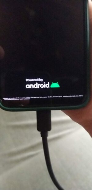

-ERROR DOWNLOAD NOT COMPLETE
-NO NEED FLASH
PROCCESS
OPEN UNLOCKTOOL
-MTK UNIVERSAL
-BOOT DEVICE
-HOLD V+ AND V- (CONNECT CABLE)
-UNCHECK ALL INFO AFTER BOOT
-LOOK FOR "OPPO CUSTOM"
-CHECK IT AND RIGHT CLICK
(DOWNLOAD THIS FILE)
https://www.mediafire.com/file/qj728cvqsdj3dt9/oppo_custom.rar/file
EXTRACT IT AFTER DOWNLOAD
AFTER RIGHT CLICK ON "OPPO CUSTOM"
- WRITE TO [ oppo_cutom 1 MiB]
- LOOK TO FILE (OPPO CUSTOM) (ITO YUNG NAIDOWNLOAD NIYO)
THEN LAST INPUT THE FILE THEN WAIT UNTIL THE RESULT IS OK

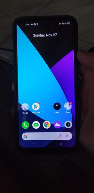

THEN DONE YOUR PHONE IS NOW OK
TESTED IN ALL MTK OPPO/REALME
KUNG WALA YUNG MODEL SA OPPO FX/DL SA MTK UNIVERSAL ETO SOLUTION NIYO
-NO NEED FLASH
PROCCESS
OPEN UNLOCKTOOL
-MTK UNIVERSAL
-BOOT DEVICE
