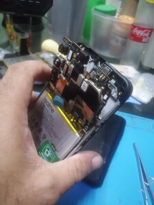

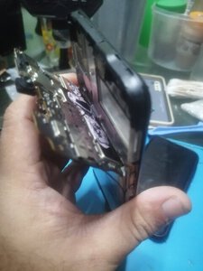

Action taken basic muna check volume + - at power switch kung may continuity upon checking ok naman
Action 2 power on muna tas hang agad ung board sa mga switch baka talaga sa switch lang ganun pa din try change battery same pa din Kaya flash na tayo

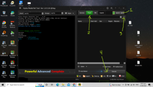

Action 3 open hydta mtk tool boot info tanggal battery para mag off hold vol + - saksak usb boot info hydra
hanap sa google flash file rmx2040 scatter file pasensya na ndi ko napicturan lahat nagmamadali si tumer yan
may log proof naman ako
http://oppostockrom.com/oppo-realme-6i-rmx2040 pili nlang po kayo
1. open hydra mtk tool tanggal bat tas balik para ma off kc restarting hold + - salpak usb boot info muna
2. click flash
3. Load scatter firmware rmx2040 eto po link http://oppostockrom.com/oppo-realme-6i-rmx2040 pili nlang kayo
4. execute wait nalang until matapos ayan po proof ko log sa baba thx
searching for MTK Device...Found
Port Identification :Flashmode BROM
FriendlyName :MediaTek USB Port_V1633 (COM5)
Device :6&3361a02a&0&2
SymbolicName :\??\USB#VID_0E8D&PID_0003#6&3361a02a&0&2#{a5dcbf10-6530-11d2-901f-00c04fb951ed}
Driver Ver :01/22/2015,3.0.1504.0
Trying to Open Port [COM5] Ok
Handshaking...Ok
HwCode : 0707 {MT6768}
Hwver : 0000
Target config : E5
SBC : 01 (True)
SLA : 00 (False)
DAA : 04 (True)
SWJTAG : 04 (True)
EPP : 00 (False)
CERT : 00 (False)
MEMREAD : 20 (True)
MEMWRITE : 40 (True)
CMD_C8 : 80 (True)
Device Connection : BROM
HW Subcode: 8A00
HW Ver : CA00
SW Ver : 0000
ME_ID : 3BDEF1C853306C8945E8A0EC89035440
SOC_ID : C85734523F1764375D8B90B0D9A6D7F8B7F95AD9976700F888F8D01498AF9E9F
Exploiting Device...
Handshaking...Ok
Dumping Preloader from Bootrom..
Seeking preloader address..Found @ 0x00200BC4
Starting to dump...
Prel Size : 0x0004C24C
Successfully dump preloader.. [C:\Hydra Tool\Boot\PreloaderDump\preloader_oppo6769.bin]
Target config : 00
SBC : 00 (False)
SLA : 00 (False)
DAA : 00 (False)
SWJTAG : 00 (False)
EPP : 00 (False)
CERT : 00 (False)
MEMREAD : 00 (False)
MEMWRITE : 00 (False)
CMD_C8 : 00 (False)
Download Agent...
DA :MTK_AllInOne_DA_5.2152.bin
Patching da2 ... Ok
Uploading data
Successfully uploaded stage 1, jumping ..
Jumping to 0x00200000
Successfully received DA sync
CONNECTION_AGENT : brom
DRAM config needed for : 90014A6843386150
Sending emi data..
DRAM setup passed.
Sending emi data succeeded.
Uploading stage 2...
Upload data was accepted. Jumping to stage 2...
Successfully uploaded stage 2
ERAM Size: 0x0000000000070000-448 KB
IRAM Size: 0x0000000100000000-4 GB
EMMC Boot1 Size: 0x0000000000400000-4 MB
EMMC Boot2 Size: 0x0000000000400000-4 MB
EMMC RPMB Size : 0x0000000001000000-16 MB
EMMC USER Size : 0x0000000E8F800000-58.242 GB
EMMC CID : 90014A68433861503E03000E63647745 - hC8aP>
HW-CODE : 0x707
HWSUB-CODE : 0x8A00
HW-VERSION : 0xCA00
SW-VERSION : 0x0
CHIP-EVOLUTION : 0x1
DA-VERSION : 1.0
Speed : high-speed
DA Extensions successfully added
Reading Partition Table ..
Partition Count : 50
--------------- Reading build.prop content ---------------
Brand : alps
Vendor : alps
Model : oplus_mssi_64_cn
Product : oplus_mssi_64_cn
Manufacturer : alps
SDK : 30
Release : 11
ABI : arm64-v8a
CPU abilist : arm64-v8a,armeabi-v7a,armeabi
Locale : en-US
Description : sys_oplus_mssi_64_cn-user 11 RP1A.200720.011 1607914664672 release-keys
Display ID : RP1A.200720.011 release-keys
Security Patch : 2022-05-05
StorageType : mtp
--------------- end of build.prop content ---------------
Bootloader Status...
Bootloader : Locked
Backing up Security..
-preloader .....Ok [preloader_oppo6769.bin]
*Creating Scatter file... C:\Hydra Tool\Backup\MTKBKUP\0707_3BDEF1C853306C8945E8A0EC89035440\Auto\081122102005\6768_Android_scatter.txt
-pgpt .....Ok
-nvram .....Ok
-nvdata .....Ok
-frp .....Ok
-protect1 .....Ok
-protect2 .....Ok
-persist .....Ok
-proinfo .....Ok
-oppo_custom .....Ok
-opporeserve1 .....Ok
-opporeserve2 .....Ok
-nvcfg .....Ok
-sec1 .....Ok
-seccfg .....Ok
Backup Done!!!
Searching for MTK Device...Found
FriendlyName :MediaTek USB Port_V1633 (COM15)
Device :7&37976604&0&3
SymbolicName :\??\USB#VID_0E8D&PID_0003#7&37976604&0&3#{a5dcbf10-6530-11d2-901f-00c04fb951ed}
Trying to Open Port [COM15] Ok
HW-CODE : 0x707
HWSUB-CODE : 0x8A00
HW-VERSION : 0xCA00
SW-VERSION : 0x0
DA-VERSION : 1.0
Speed : high-speed
Brand : OPPO
Vendor : OPPO
Model : oppoEffectModel
Product : oppo6769
Manufacturer : OPPO
SDK : 29
Release : 10
ABI : arm64-v8a
Locale : en-US
Description : full_oppo6769-user 10 QP1A.190711.020 68b77aba7cb33275 release-keys
Display ID : QP1A.190711.020 release-keys
Security Patch : 2021-06-05
StorageType : mtp
Bootloader : Locked
HW-CODE : 0x707
HWSUB-CODE : 0x8A00
HW-VERSION : 0xCA00
SW-VERSION : 0x0
DA-VERSION : 1.0
Speed : high-speed
Brand : OPPO
Vendor : OPPO
Product : oppo6769
Manufacturer : OPPO
SDK : 29
Release : 10
ABI : arm64-v8a
Locale : en-US
StorageType : mtp
Bootloader : Locked
Write Selected Partitions..
-preloader .....
-opporeserve2 ..... Ok
-vbmeta ..... Ok
-vbmeta_system ..... Ok
-vbmeta_vendor ..... Ok
-cdt_engineering ..... Ok
-logo ..... Ok
-md1img ..... Ok
-special_preload ..... Ok
-my_custom ..... Ok
-spmfw ..... Ok
-scp1 ..... Ok
-scp2 ..... Ok
-sspm_1 ..... Ok
-sspm_2 ..... Ok
-lk ..... Ok
-lk2 ..... Ok
-boot ..... Ok
-dtbo ..... Ok
-tee1 ..... Ok
-tee2 ..... Ok
-super ..... Ok
-recovery ..... Ok
-cache ..... Ok
-userdata ..... Ok
Rebooting Device...
Reboot Option : RebootToNormal
Rebooting Operation Done!!!!
Done Writing...
Elapsed Time : 00:09:15
