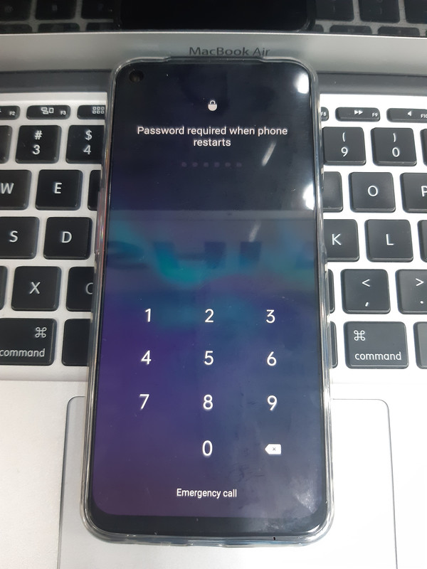

HISTORY: Nakalimutan ang passcode.

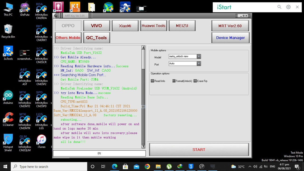

Open MRT V3.95
Select OPPO
Go to MODEL
Select META_UNLOCK NEW
Thick FORMAT UNLOCK
Hold volume up and volume down
Insert usb cable
done
Automatic mag power on ang unit at may katagalan hintayin nyo
lang hanggang sa lumabas yung WIPE DATA at FORMAT
FORMAT ang e select nyo para mag success and dial *#813#
done
