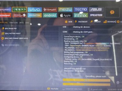

WESTlee_21 Moderator Staff member Joined Jun 22, 2021 Messages 544 Reaction score 510 Points 121 Location lapaz,tarlac Feb 16, 2023 #1 "Realme 9i Frp Bypass Via UnlockTool" Procedure: Open Unlock tool: Click Oppo Click Realme 9i (edl) RMX3941 Click [EDL] ERASE FRP Hold volume + and volume - Insert cable DONE....
