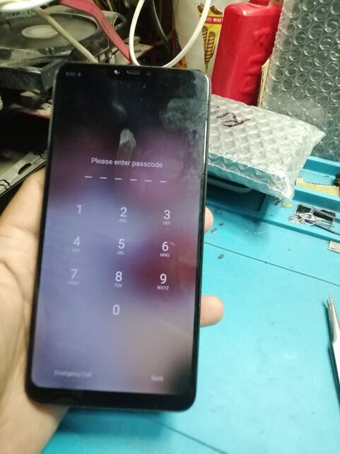

Realme C1 Password Problem Done kay Hydra
Procedure natin :

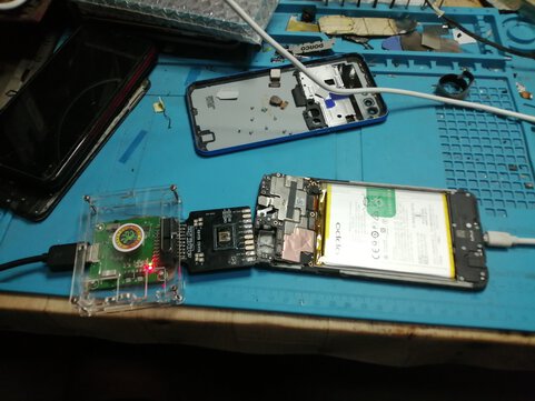

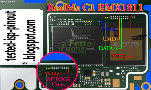

1. First ISP niyo muna See image below para sa isp sundan niyo lang ( sakin d ko na sinama yung VCCQ pwede na yun connect charger and note baklas yung battery then)
2. Open Hydra Tool Go to Direct EMMC tab
3. Connect na Kapag nag green indicator its mean connected na ( see image below)

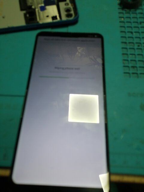

5. Tick Service Tab Then Click Safe Format Method 1
6. Wait till done !

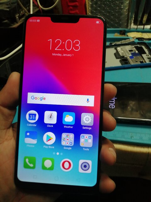

On your Cp wait lang Sa Wiping then Ok na !
