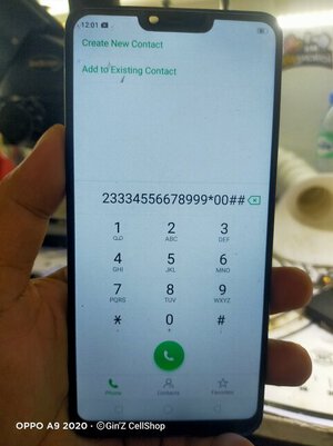

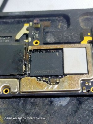

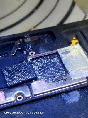

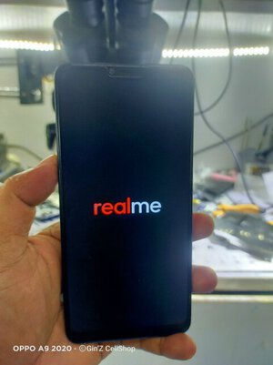

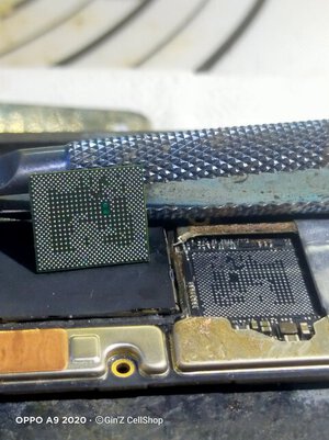

Realme C1 Touch not working, pag dating d2 sa shop inspect ko motherboard malinis nman, check diode reading sa borneo schematics normal nman at present nman 1.8v pero lahat nang line nang touch papunta lahat sa CPU kaya nag baka sakali ako at d nman na bigo :cool:
Tanggal CPU - Heat 380 Air 60
Balik CPU - Heat 380 Air 35
Reablling Paste Mid Temp 158°
Done po sana mka tulong :cool:
