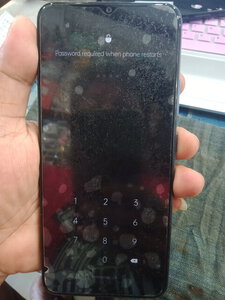

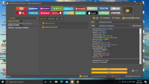

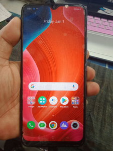

tsunami Registered Joined Jan 5, 2015 Messages 244 Reaction score 42 Points 1 Location Surigao City, Surigao del norte Oct 9, 2022 #1 ito sya naka pattern pa -hard reset first -hold volume down + power switch -wipe data -sa frp nman open unlock tool -click oppo -search rmx 3231 -click [SPRD] RESET FRP ito na finish product
