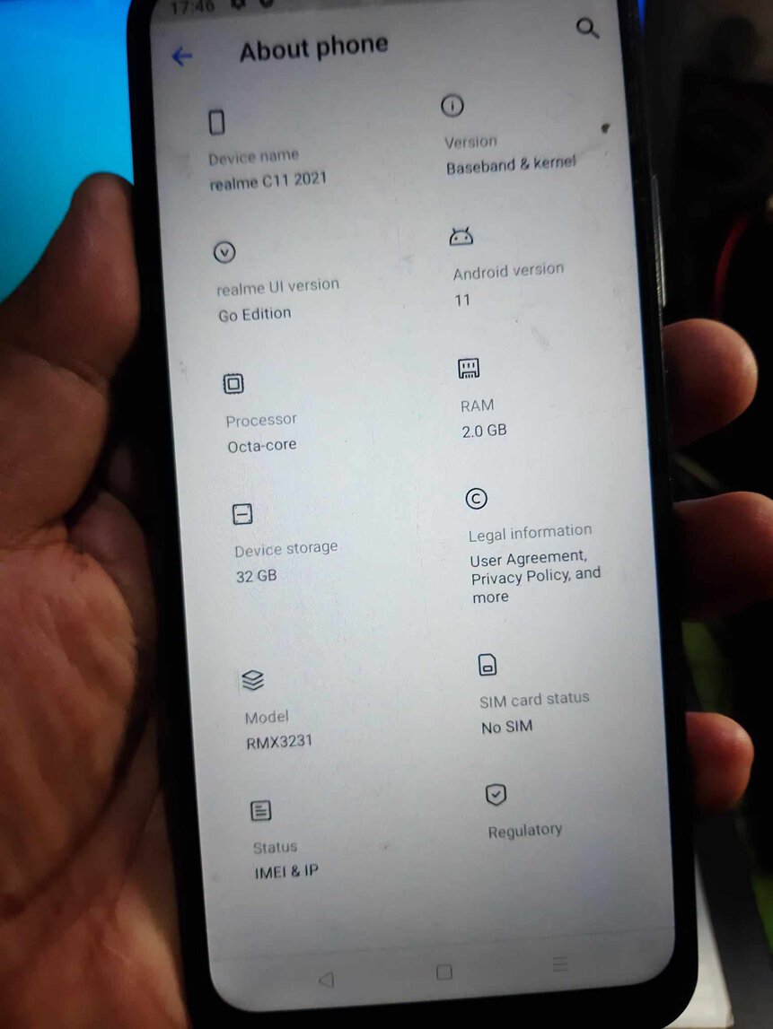

REFERENCE Realme C11 2021 RMX3231 done with tested firmware & tools

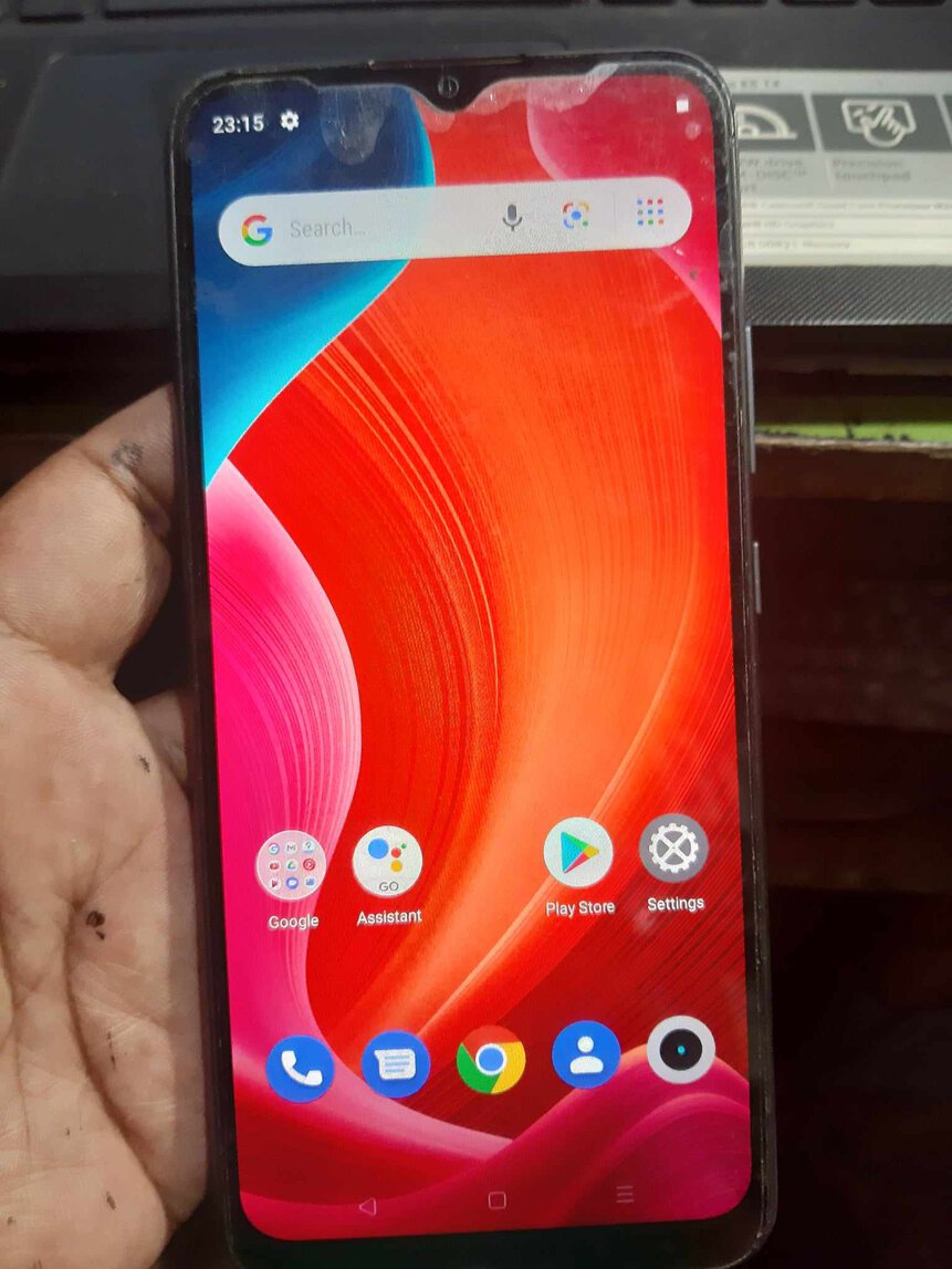

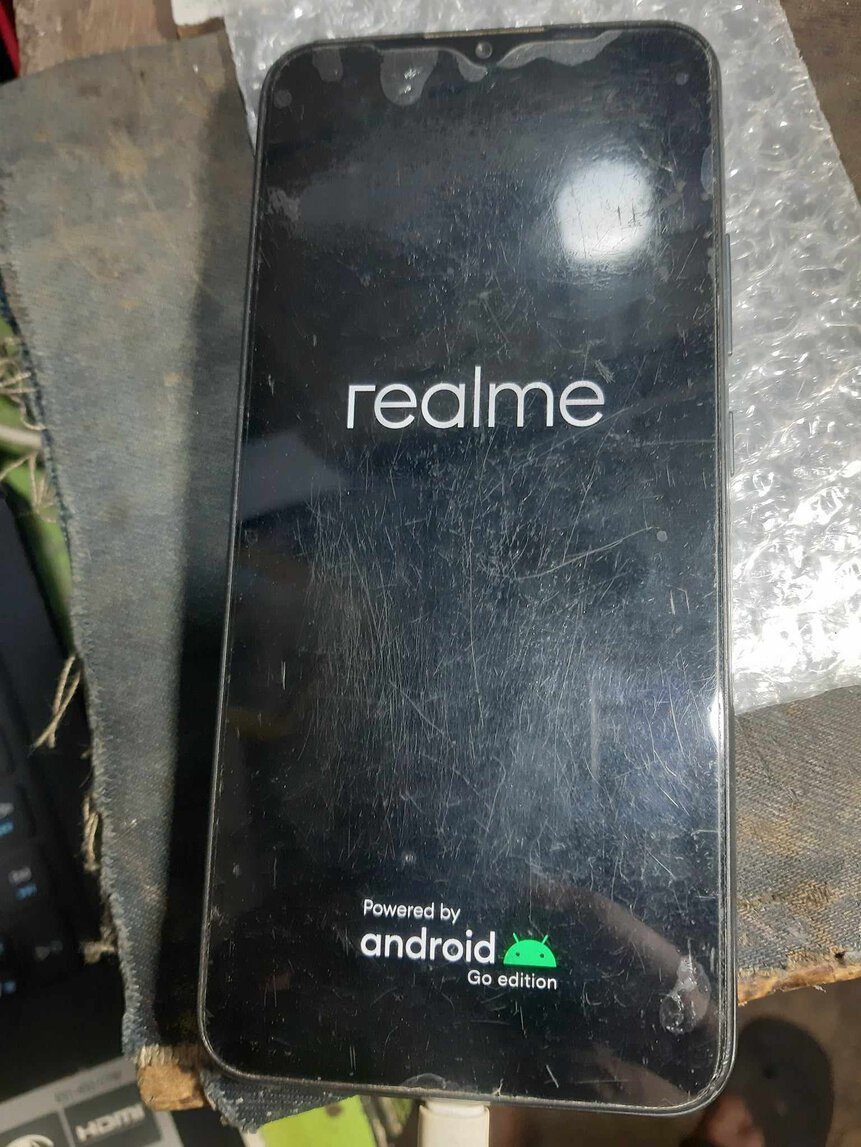

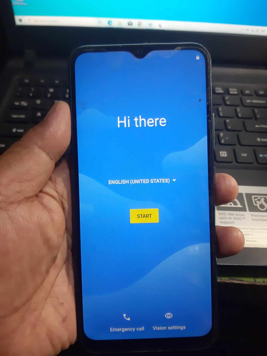

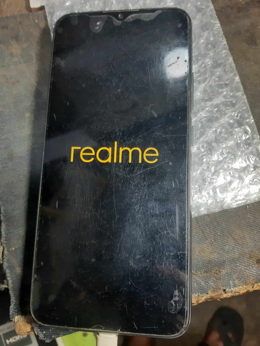

problem of phone - always restart in realme white & realme yellow

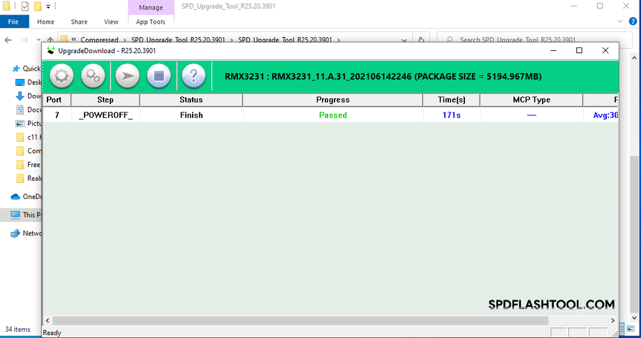

solution download this firmware & tools
And flash done
see picture below
tanx for viewing:)
Try palit lcd boss nakaencounter na ako nyan c11 2021 auto restart problem after flash vibrate nalang nakailang firmware din ako ganoon parin so i try new lcd ayun bumukas sna makatulong
try ko to boss ayaw talaga bumukas naka tatlong flash na ako.
tested po ung fw.tnks
