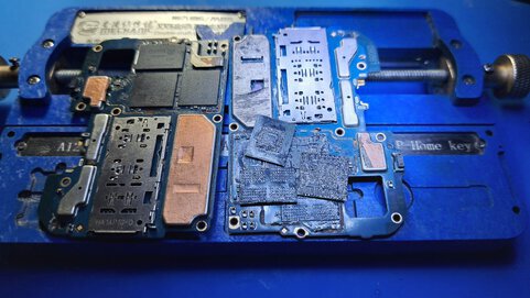

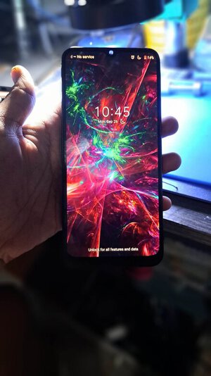

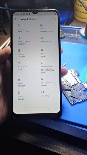

Issue water Damage

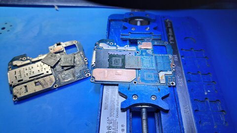

Need ni tumer mga Files kaya proceed na sa Transplant
Tools Needed
-Quick 2008
-Mechanic Solder Paste
-Cpu Sm8150/Ram Sm8150 Stencil
-Sexy Blade
-Mechanic Disoldering Wire L1.5m 2.55mm W
-Amtech Flux
-To remove Emmc,Ram and Cpu HEAT 380 AIR 60
-To put it back Emmc, Ram and Cpu Heat 370 AIR 40
Pm lng mga boss if need niyo>(Box Actions/Remote Services)<
