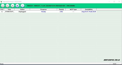

1st step na ginawa ko bka ung switch ang problem negative kaya nakakuha ako ng tested firmware sa YT.
2nd :
DL nio tong file : https://www.mediafire.com/file/gztv...woiFnwtieNpnllZCt30hH7Uyv9rzGWbmt8cv001sZ26eA
3rd DL nio tong Tools:
https://www.mediafire.com/file/299f6gwerxmspa3/TOOL_DAN_DRIVER%5BUPLOAD_BY_KRESEX_CUAN.7z/file
see pic below:
alam nman na cguro kung pano gamitin tong tools:

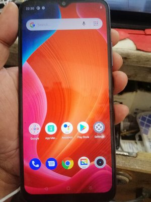

ayan that time nag passed na hndi ko na pic ung actual:
press volume down to detect
sa frp nman *#813# lng pasok na yan...
sana makatulong
