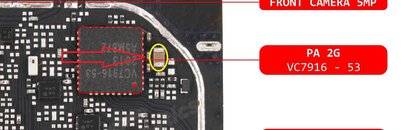

REALME C12 NOT TURNING ON FIX !
SHARE KO LANG PO ITONG TANGGAP KO GALING SA TROPANG COTECH PO
REALME C15 PO ANG ISSUE PO AY BUHAY DAW PERO PAG ICHARGE NAKA STOCK SA
CHARGING LOGO NA ANG SABE NYA NAKA DALAWANG BATTERY NAMAN SIYA NA MAY LAMAN PERO HINDE DAW NAG OOPEN .
GANYA LANG SIYA PAG ICHARGE STOCK SA CHARGING LOGO .
BASE SA AKING EXP PANGALAWA NA ITONG TANGGAP KO NA GANYAN REALME C12 RIN
KAYA TINIGNAN KO KUNG TAMA ANG AKING HINALA
BASE SA AKING PAG CHECK SHORT TO GROUND ANG UNIT NYA MEANING SHORTED PO KAYA HINDE TALAGA MAG OOPEN ANG UNIT .
KAYA GINAWA KO SINILIP KO SA THERMAL CAM KUNG SAME BA SA DATE KONG GINAWA ANG PROBLEMA NG UNIT NA ITO .
AT NAG PAKITA NGA ANG SALARIN
SHORTED SI CAPACITOR SA TABE NI POWER AMPLIFIER OR PA 2G IC
NIREMOVE KO LANG ANG SIRANG CAPACITOR SABAY TEST ULIT SA LOGIC BOARD KUNG SHORT TO GRND PA
AT BOOM WALA NANG SHORTED HAHA
NAG CHARGE AT NAG OOPEN NA ANG PHONE.
