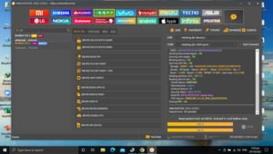

tsunami Registered Joined Jan 5, 2015 Messages 244 Reaction score 42 Points 1 Location Surigao City, Surigao del norte Oct 8, 2022 #1 -manual reset muna -hold volume down + power -wipe data -sa frp nman -open unlock tool -click oppo -search c12 -click [BROM] erase frp -insert usb cable hold volume up down hintayin matapos ito na finish product
