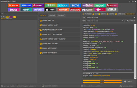

muziquerou Expired Account Joined Nov 8, 2020 Messages 83 Reaction score 145 Points 201 Location Pangasinan Dec 17, 2022 #1 share ko lang mga boss 1. open TFT tool 2. select oppo 3. type c12 4. click security tab 5. click (brom) factory reset/erase frp 6. off unit hold vol + vol - wait until done sana maka tulong
Brooke'sPoint Premium Account Joined Aug 17, 2014 Messages 323 Reaction score 28 Points 31 Location Pampanga Dec 18, 2022 #2 Anong Driver mtk ginamit mo dyan ts sa TFT Tools kasi sakin ayaw mag detect ang MTK pero ibang tools na dedetect ang mtk
muziquerou Expired Account Joined Nov 8, 2020 Messages 83 Reaction score 145 Points 201 Location Pangasinan Dec 19, 2022 #3 Brooke'sPoint said: Anong Driver mtk ginamit mo dyan ts sa TFT Tools kasi sakin ayaw mag detect ang MTK pero ibang tools na dedetect ang mtk Click to expand... Install mo lang boss drivers ng TFT
fix_solution Registered Joined Jul 25, 2014 Messages 295 Reaction score 90 Points 1 Location ROBINSON NOVALICHES MDM CELLPHONE & ACCSS. 2ND FLR Mar 8, 2023 #4 maraming salamat po boss tested ko po ngayon
van2x Expired Account Joined Dec 21, 2021 Messages 44 Reaction score 53 Points 201 Location Mabini Davao De Oro Apr 29, 2023 #5 tnx boss tested
bhongskie1801 Premium Account Joined Mar 29, 2016 Messages 68 Reaction score 90 Points 51 Location Daet, Camarines Norte Aug 29, 2023 #6 Salamat Boss Tested
RipCordTechDVO Expired Account Joined Aug 13, 2023 Messages 21 Reaction score 29 Points 201 Location Ising, Carmen, Davao del Norte Oct 2, 2023 #7 Tested to Pero sa Mediatek ako nag Punta hehehe Salamat master
