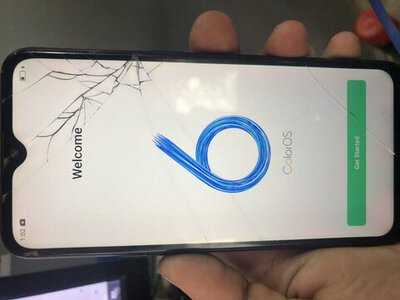

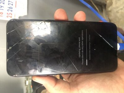

Good dy mga boss share ko lang tong realme c2 bootloop siya ng dinala ni tumer,.
ginawa ko nag update lang ako via sdcard at gumana naman.
ito ang link:
droidfilehost.com
Hold power button plus volume down papasok siya sa recovery select mo yung phone storage tapos select sd card kung saan nakalagay yung files
Ito pala yung proof na success siya.
ito ang link:
Download Realme C2 RMX1941EX_11_OTA_0320 Firmware Flash File
Download and Install the Stock ROM flash file (RMX1941EX_11.A.32) on Realme C2 powered by a MediaTek MT6762 Helio P22 processor and runs on Android 9.0 Pie under the hood. This…droidfilehost.com
