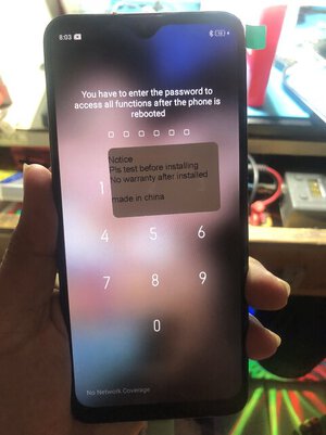

Realme C2 rmx1941
Problem: password & frp
Procedure:

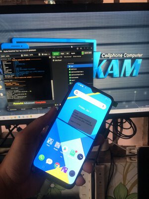

Open hydra mtk tool v1.0.5.35
install mtk drivers
install Libusb drivers
Brand Auto
Storage Auto
Click boot/info
Bootkey up & down
insert unit
Wait until finish..
Next tab Service / Tool / Ultra Power / Auto
Check auto reboot
Click Execute
Wait until..
DONE!!!!
