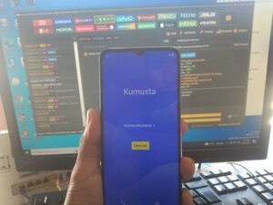

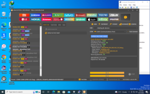

procedure:
STEP 1 open unlocktool
STEP 2 click oppo
STEP 3 select model realme c21y v2
RMX3261 / RMX3262 - Spreadtrum T610
STEP 4 click [SPRD] FACTORY RESET
STEP 5 off ang unit then salpak usb wait until done no bootkey seconds only

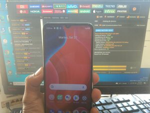

STEP 6 pag may frp dial lang sa emergency call *#813#
