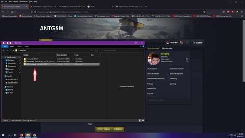

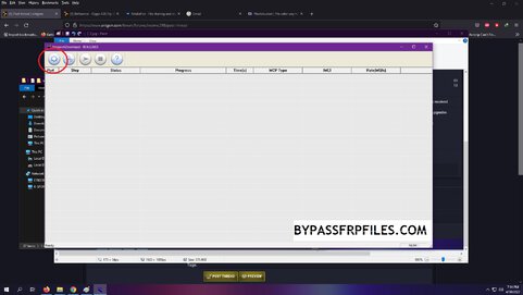

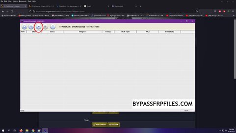

STEPS NA GINAWA KO

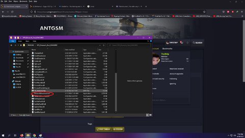

open SPD RESEARCH TOOL FOLDER
hanapin
hanapin ang researchdownload.exe

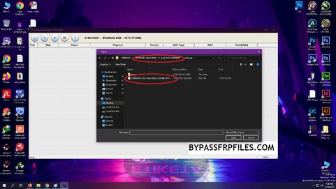

Run
Press nio to at hanapin and pac file na kasama sa folder
firmware folder
tapos open nio na
press play button and connect phone via usb
HOOOLAAA OK NA MASAYA NA ANG BATA
hanapin
Run
firmware folder
tapos open nio na

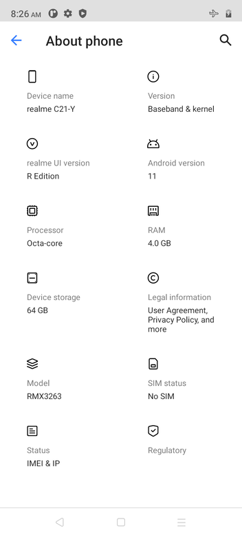

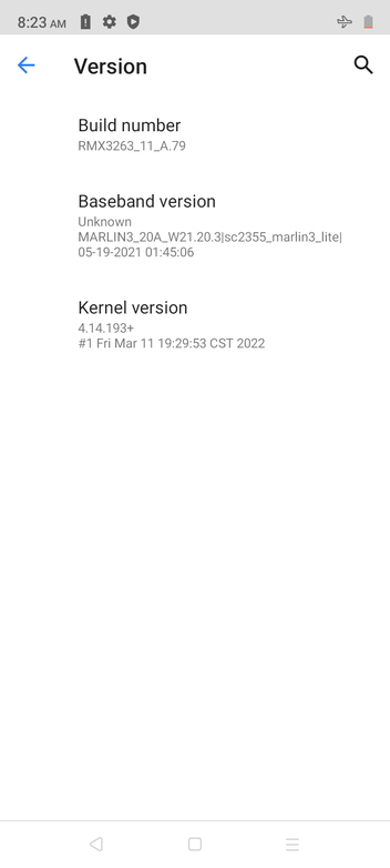

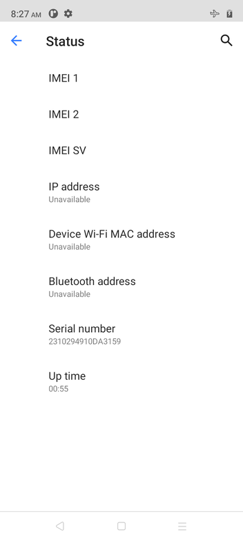

Sinubukan ko ito, unknown baseband na ngayon. Tapos nagrereboot after 2-3mins, RMX3263_11_A.79 version. Baka meron kayo?
Nasubukan ko na yung version RMX3263_11_A.68, RMX3263_11_A.71 pero stuck lang sa CM2 "Kick FDL...", sa Upgrade Download stuck lang sa FDL Checking baudrate.
RMX3263_11_A.73 naman, ito ang error.
Any idea mga sir?
Any idea mga sir?

hanap ka exact fw boss,at full flash mo..............nangyari na sakin yan ibang version lng yung akin.
Any idea mga sir?
View attachment 8425View attachment 8426View attachment 8427View attachment 8428
try mo dito na version https://oppostockrom.com/realme-c21y-rmx3263
