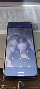

REFERENCE REALME C21Y RMX3263 PATTERN REMOVE BY HYDRA TOOL LATEST UPDATE 2022

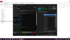

PROCEDURE
NOTE MGA DOL BAGO NTEN SIMULAN
SPD UNG CP KULITAN SA PAG READ
POWER OFF PHONE
SALPAK DONGLE
OPEN SPREADRUM MODULE
SELECT BRAND
SELECT MODEL
POWER OFF PHONE
HOLD BOOTKEY VOL UP AND DOWN
SELECT SERVICE TOOL
CLICK BOOT INFO MONA PARA ND MAG ERROR MAG READ C HYDRA

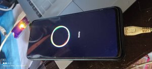

AFTER BOOT INFO
CLICK FACTORY RESET/FORMAT DATA
AND CHOOSE "SAFE FORMAT"
WAIT GANG MATAPOS

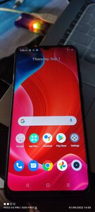

DONE
PICTURE PARA SA PROCEDURE
FOR FRP
