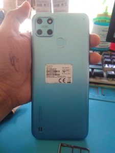

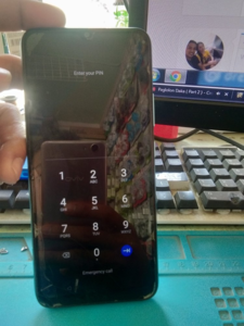

status; naka password, nakuha sa basic move's mga boss ..
1st; off nyo lang po si phone realme,
2nd; press vol- down & power together, wag nyo po bitawan hanggat di lumabas si logo realme, at pag lumabas na bitawan nyo po si power,
si power lang po wag muna si vol down, by the second lalabas po si NO COMMAND saka nyo na bitawan si vol down.
3rd; para lumabas si android recovery, press mo muna lahat vol+ vol- power, pgkatapus ipagsabay mu pindutin si power at vol+ up . pg wala ulitin mulang.

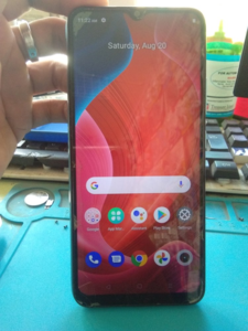

4rth; press vol down to select wife data/factory reset. press power to ok. after reset e reboot system muna si unit.

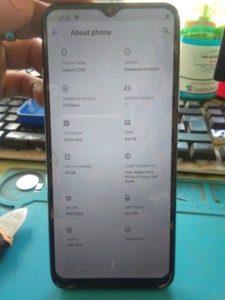

yes sa frp problem naman po just dial *#813# auto menu na kaagad done
