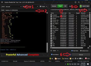

Realme C3 Deadboot done sa tested firmware sa hydra tool
https://mega.nz/file/XrxQhDAD#SbGLPynsrEJBuzNdPNPmyPCFsbclpDY6ThLK58Tn6Nc
open hydra MTK tool
1 & 2 . select model
3.boot info muna
4.select flash tab
5.load firmware
6.execute
7.salpak na ang unit auto detect naman sya

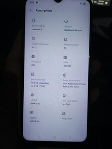

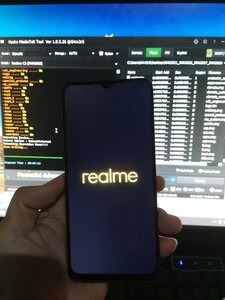

after done ito na finish product
